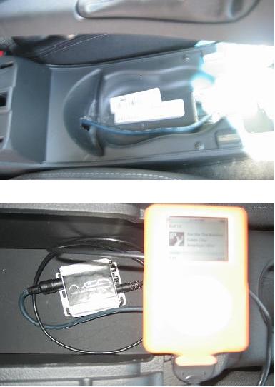

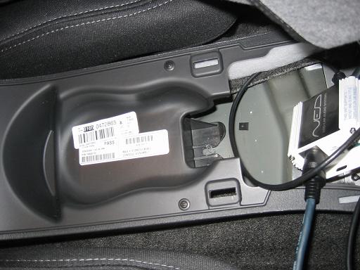

Hi,
I got the neo ion ipod adapter all installed.
It works and sounds great.
My only problem now is that I want to run the
cable lines through the center into my center
armrest so that I can hook up the ipod and leave
it in there.
How the heck do I do that? Do I have to drill??
I can't seem to figure out where to go from here.
Here is a picture of how far I got.
Thanks for your help.
- The_Duck

Old 04-07-2006, 10:04 PM

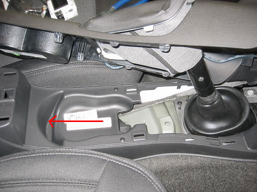

You'll probably have to drill a hole to get it inside the storage area.
I haven't taken that section apart (yet ) but from the picture it looks like you should be able to run the cable along either side of the tray. Then you can drill a hole at the bottom of the armrest storage and fish it through there. Good luck.
Old 04-07-2006, 11:21 PM
If you drill a hole here doesn't it go into the storage area?

Holy crap... thats where mine is... got a hard case and drilled it into the recess there on the bottom of the armrest that flips up. only hole I drilled was at the base where the hinges are. From there I was able to feed it down and snag it with a coat hanger to tuck the length near the carpet to the dash. I didn't dis-assemble anything on the center armrest. Will try to post pics this weekend.
The cup holder top would be covering that area and I am not sure if there would be enough room for the wire once the cover is back in place. I was thinking maybe somehow getting UNDER that grey flat area you indicated.

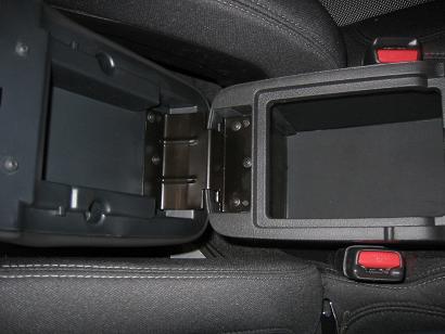

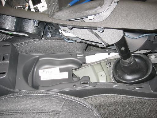

Below are 3 more pics of the center area.
- The_Duck

Old 04-08-2006, 01:48 AM

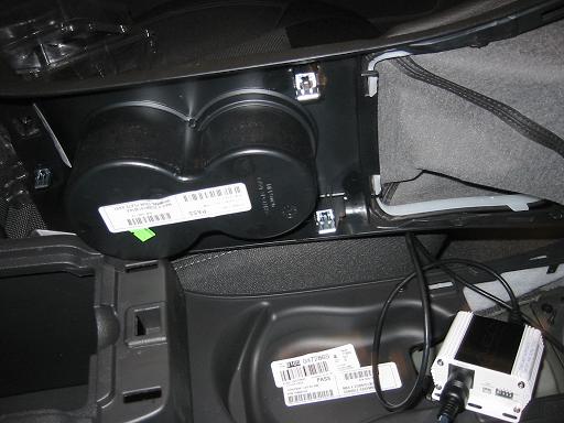

more of the center area with the neo-ion/wires and where the top cupoholder snaps back down
- The_Duck

back of armrest where I think nmikes was referring to where he drilled a hole?

Old 04-08-2006, 02:33 AM
Try to find something the same diameter or slightly larger diameter as the wire. Place it where you might drill, them place the cover back in place. If it doesn't hit the test item, then you should be fine.

yep, thats the place... however I wasn't entirely honest about not taking anything apart. If you unscrew the armrest, drill your hole you can run the wire around the hinge once you screw the armrest back down. So the hole drilled is unnoticable, being covered by the hinge.

This should give you some idea hopefully.

How it looks from the wheel.

Should I even bother to ask you how you fished that all the way underneath the armrest? Impressive.

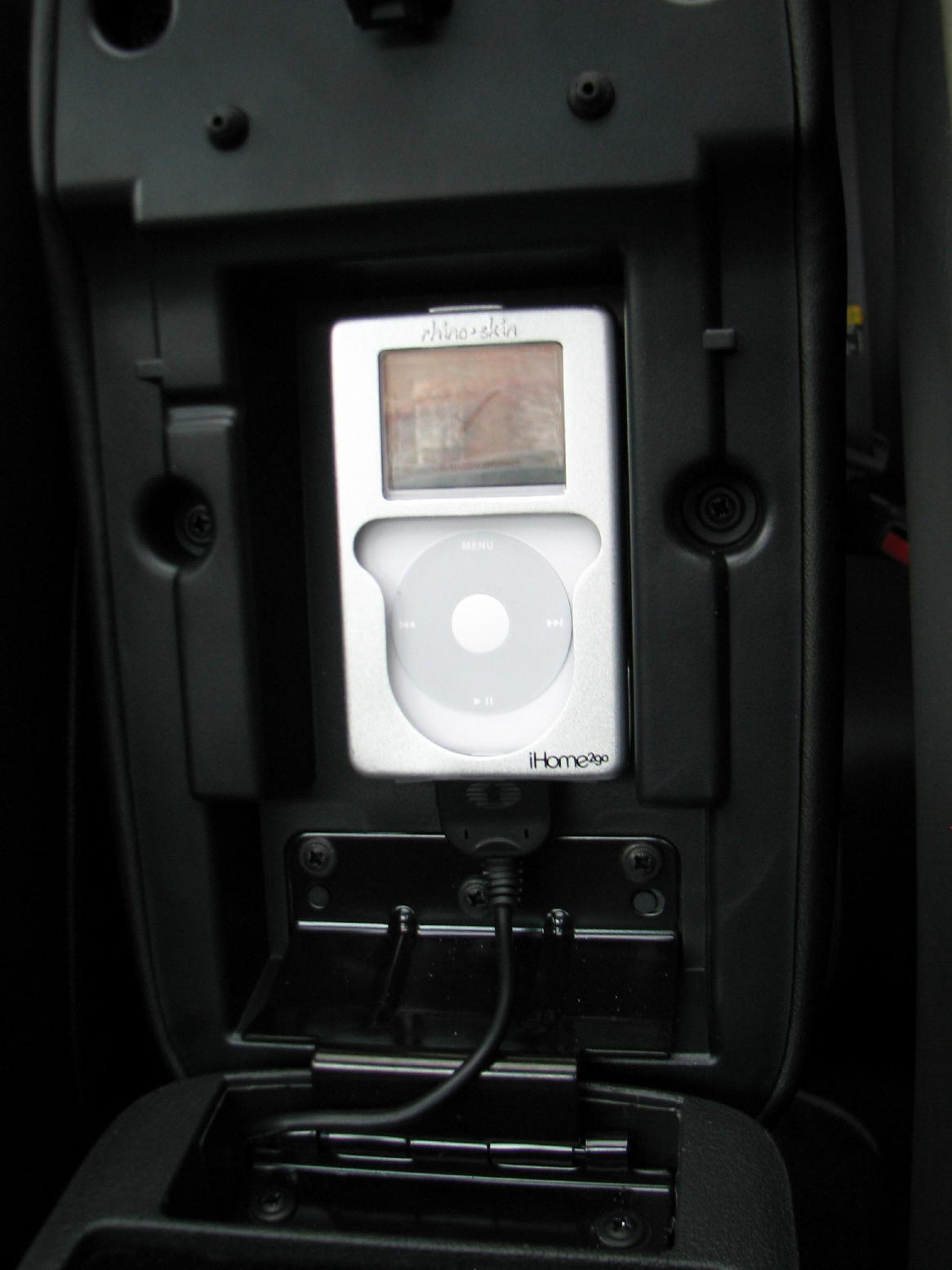

Old 04-09-2006, 04:23 PM
The_Duck The_Duck is offline
Location: Boston
Posts: 22
The_Duck is off the scale
Sweet! I did it!
Thanks for the suggestions!
Here are the two final pics. The drillhole was a hackjob, but it worked.
- The_Duck
