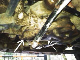

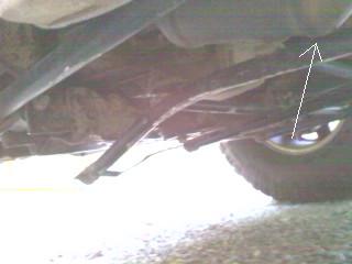

I didnt some rockcrawling last night... I smashed the "H2" skid plate covering the diff. HARD pulled 1 bolt out. The undercarrage ladder protection is completely shot. Its pushed up into the exhaust touching the CAT, pulled out the 15mm bolt on the drivers side peeling the corner back, The differential support near the Lower control arm is bent and dented in 2". And the drivers side door hits the front fender when opening now so I guess It twisted a little bit...
soooo back to my ?? does anyone make heavyduty skid plates or should I start making my own??

I attached some pics first one arrows show Bent Diff Support.
Second pic arrow shows cage pushin up cat over 1" and you can see the 5" it peeled down after the bolt gave out in the front.

yesterday I snuck my SUT on to a lift at my buddys shop quickly in between customers so i could get a better damage assement..... i didnt find anymore upfront. But i am very concerned about protecting the Fuel tank now!! its scratched to crap!! luckily i didnt tear it and spill 20+ gallons of fuel.
looks like I am gonna make my own plates at this point. 1/2 min steel plate maybe Hardox plate! if I can find it local . problem is I dont have the presses of brakes needed to work such thick material. there is a GREAT metal fab shop minutes from me. I will be stopping over monday morning to see what they say.

1/4" steel plate should be more than enough. 1/2" will be way too heavy
You can easily strengthen the OEM ladder rack by hammering in some 3/4" reabr down inside the tubes and welding it in. Of course, your requires straightening first
