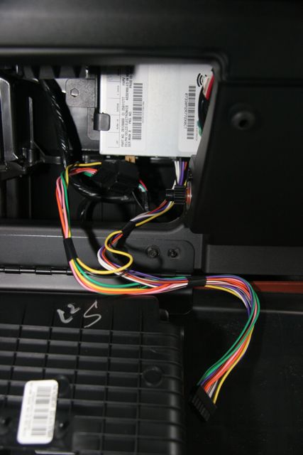

Hi All,
In this post I will detail the installation process of a Coastal Tech Ipod Lockpick in my 2008 SUT.
Ipod Lockpick:
Note: Turn off the ignition and take out the keys before proceeding.

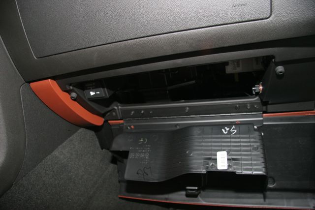

1. First open and empty the glove box. When you look inside the box, on the top right is a plastic tab that you can push up to allow the box to swing all the way open - down toward the floor. You will see the factory XM unit on the right side of the cavity behind the glove box.

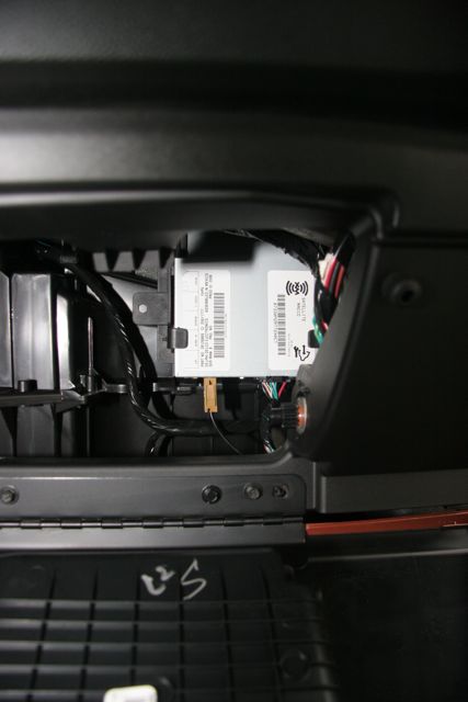

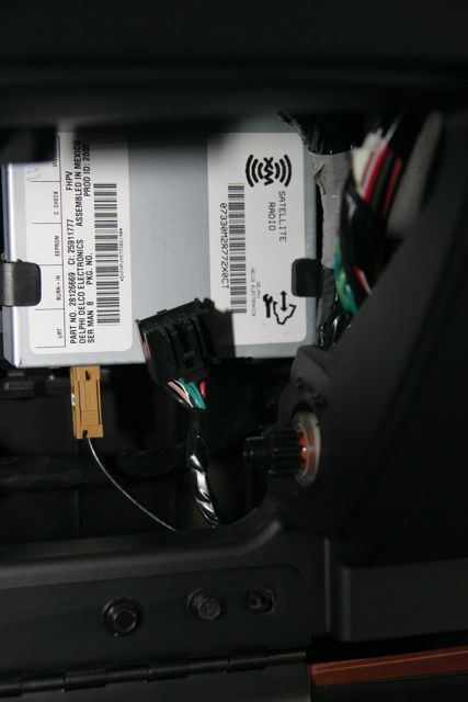

Here's the XM unit.

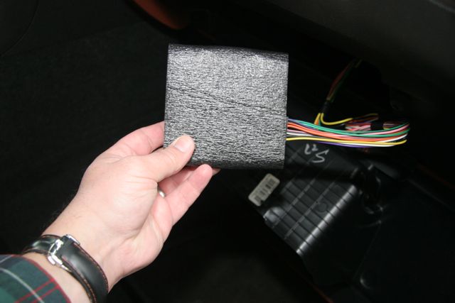

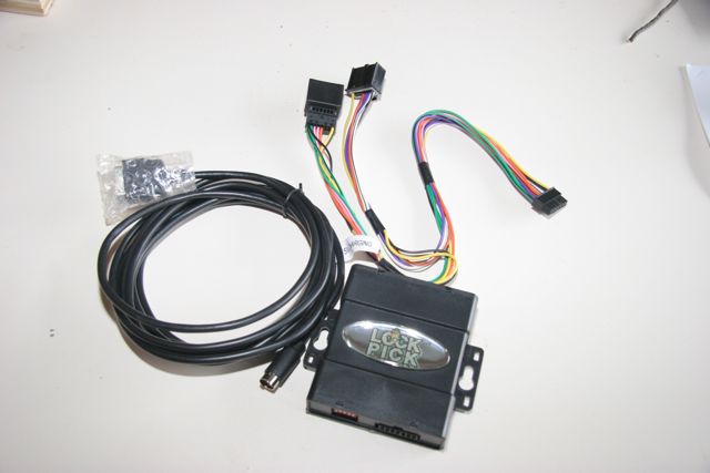

BTW - Here are the contents of the Ipod Lock Pick kit:

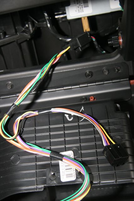

2. Remove the large black plug from the bottom of the XM unit (the instructions tell you to remove the XM unit from the cradle but there is no need to do that).

3. Plug the black connector from the factory harness into the female connector on the Lock Pick harness.

4. Plug the male black connector on the Lock Pick harness into the XM unit.

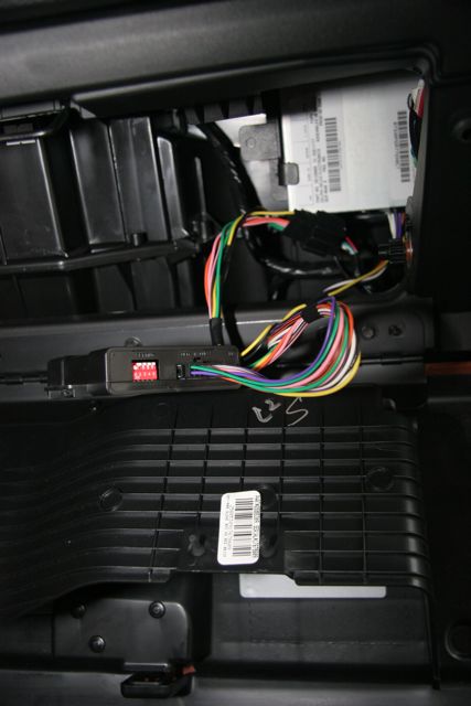

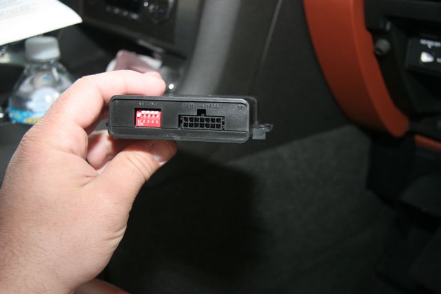

5. Check the settings of the switches on the Lock Pick unit - on my 08 SUT with XM & Nav this is the correct setting:

6. Plug the 16 pin connector from the Lock Pick harness into the Lock Pick.

7. I wrapped the Lock Pick unit in foam to prevent rattles.

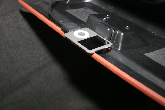

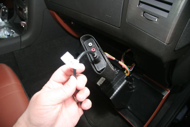

8. Route the Ipod wire to your desired location - mine is on the left side of the Glove box and connect the wire to the Lock Pick unit.

9. Place the Lock Pick unit and the extra wiring behind the XM unit (near the cabin air filter) and close the glove box.

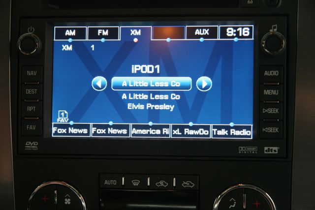

10. Plug in the Ipod and switch on the ignition. Press and hold the "Seek" button on the lower right corner of the radio to toggle between XM and Ipod.

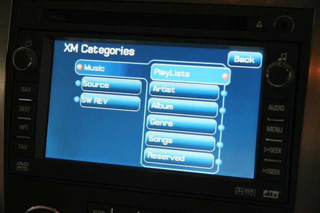

Default Re: Installing an Ipod Lock Pick on my 08 SUT
Second Screenshot
