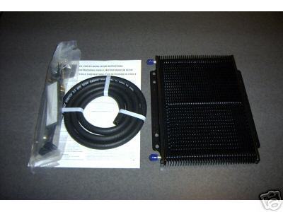

Hi Mark is the one your using like this? or the s tube type? This kind is much better than the tube type. Behind the grille is the best place. Could it be mounted in front of the intercooler or beside it? I know their is not very much room but it would be better. A deep trans pan would also help abit. If you lived in a cold place like me you would want to run it through the rad cooler to, but i think its petty warm where you are all the time so its not needed, but the cooler needs to big enough to cool when pulling a trailer. Some 4.56 or 4.88 would help to if its lugging bad enough.
