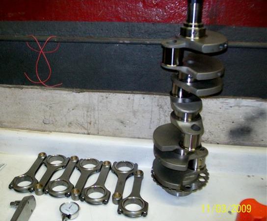

I am a retired Army soldier living in Germany. I have a 2003 H2. Was a bit underpowered, so it has been transformed into a 6.7 liter (408 CI) beast. It is still in the shop (Rays "Classic" Garage) in Oregon. Should be finished in the next three weeks. I will ship it Germany to infuriate my neighbors on Sunday morning as well as the the Polezei in mid December. I will post some pics of the completed project and some tech photos of the engine and transmission mods. Most of the components are listed in my signature block. Prosit!
2003 H2, 408 CI, K1 Forged 4" stroke crank, K1 6.125" forged rods, Wiseco X-Series 0.30 forged pistons, Schneider cam, FAST 102mm LSXRT, precision flow injectors, Comp Pro Magnum rockers, SA Gear DR timing set, ARP main studs, 90mm ETC TB, Airaid MIT, MSD Coils/wires, Dynatech Headers/high flow cats, Magnaflow, Jessie James Black Widows 20x9, Nitto Dune Grapplers 37", Fabtech 6" lift, CK Performance XHD 4l70e and 4.56 Gears

Well, I have seen a lot of inflated HP figures on the internet. Most are bolting on headers, exhaust, CAI and a chip and claiming 550-600 HP. The stock LQ4 should put out about 325 HP and 370 ft lbs of torque. I have much more than this on my engine, and I know I wont get these numbers.
I could have put out more top end HP, but I am not drag racing it. I decided to make it a torque monster with the cam grind and intake. If I went to a more radical cam and different intake, I am sure it would be around 550 HP at 6200 RPM or so. With my cam grind and intake, I am looking at 480 Hp at 6000 RPM and 450+ ft lbs of torque at 5000 rpm.This is just a SWAG, we will see what it really does on a dyno. It will make great power from 1500-5000 RPM, and have more low end torque and more HP at lower RPMs than the drag/street racing motors.
Sorry for the long speech, but I wanted to explain why the HP numbers are not as high as most claim...

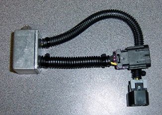

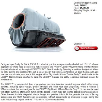

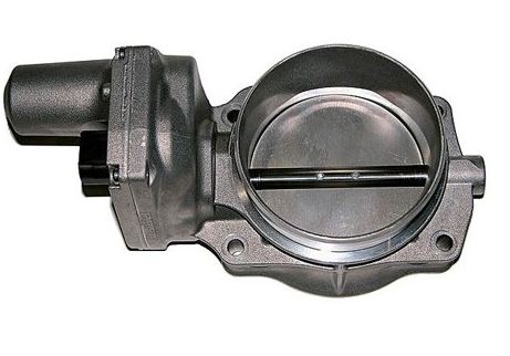

Just ordered the new FAST LSXRT 102mm Intake, adapter harness and LS7 90mm Throttle Body from a late model Vette. If this does not push it over 500 HP I give up....
Tracy, as for the "cost too much for gas" boys, we will have to spice it up a bit. Some of those girls who hang off your Hummer could show up and maybe they have some motivation to drive a bit.....If not, I guess it is just you and m.e We get all the beer, girls and bratwurst

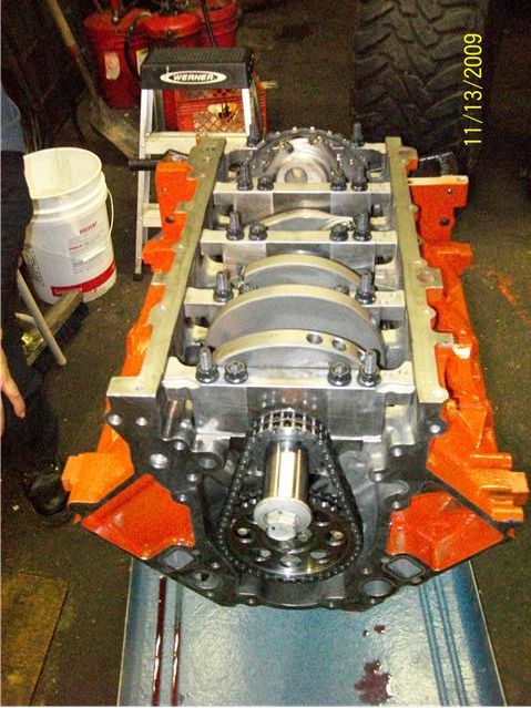

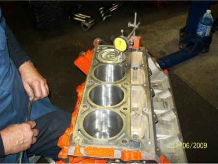

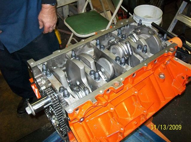

Default Short block done....its going to be bad azz!

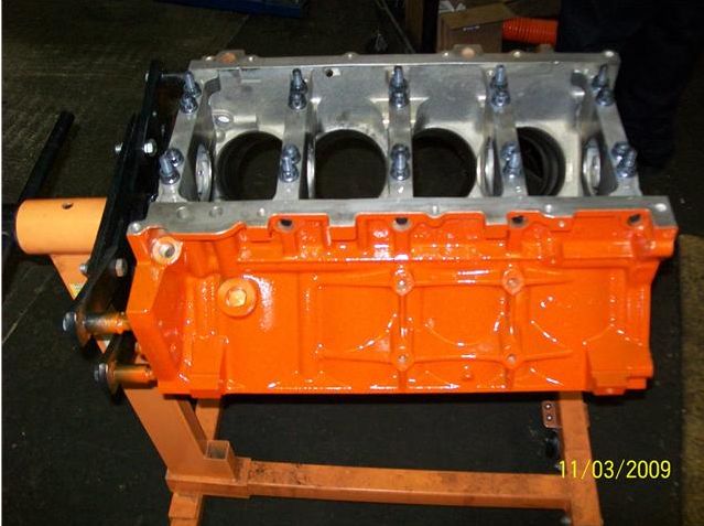

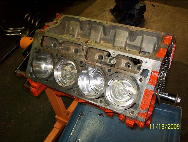

Short block is done. Waiting on the FAST LSXRT to come in. Will be fabricating an intake since there is not one I know of for a Hummer with a 90mm throttle body. Anyone who knows where I can get a 90mm elbow and tubing to make one?
Had to modify oil pump to clear new timing set and modify (heat and hammer) the windage tray to clear the stroker crank.
Ordered a MSD Dashhawk...so the 0-60 times and 1/4 mile times can be done on the Autobahn soon.

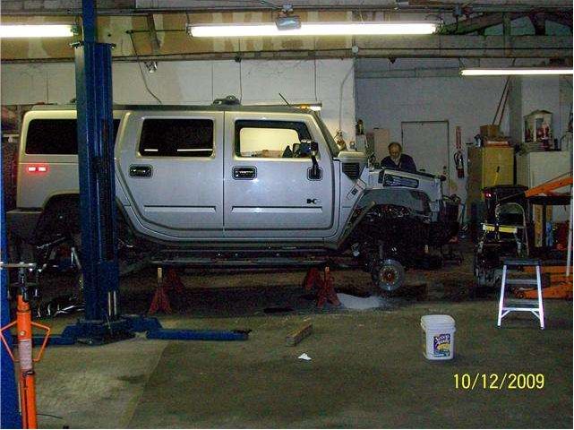

Shipping the 408 EuroHummer 28 December to Bremerhaven, Germany. Will stop by the Hummer Racing Club in Bochum on the way down south. Looking at some real off road fun. Might try my hand a some off road racing.

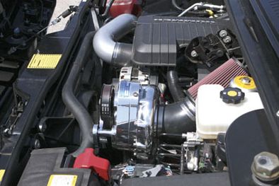

Contemplating a procharger Name:  procharger.jpg
Size:  24.6 KBto boost the HP up into the 800 range. I think I will destroy my 4L65e soon, so I am looking at an 80e. We will see how she runs in a few weeks when the intake and fuel rails come in. FAST/Comp Cams is still manufacturing the first fuel rails and hardware to put the LSXRT manifold on a chevy/hummer truck. I may be the first customer in the world to receive the new intake and hardware and get it on a rig and running. My H2 engine is in the truck, only waiting on the intake components to fire up. Will hand build the CAI from 90mm tubing and hoses I bought online.
They are telling me 30 hp increase with my setup. I wont know for sure, because I am not going to dyno it with and without the LSXRT.
