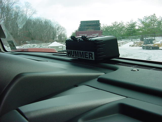

Here is the dash strobe. I removed the stickers and the switches. I placed a piece of aluminum on the holes and made sure I knew what kind of truck I was driving with the sticker! I also ran the wires out the bottom and shaved the front angle off of the housing to fit the flat windshield. The defrost works fine

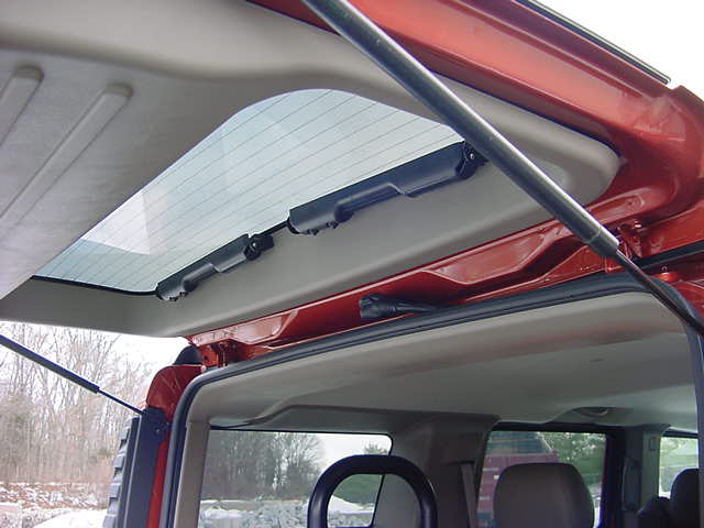

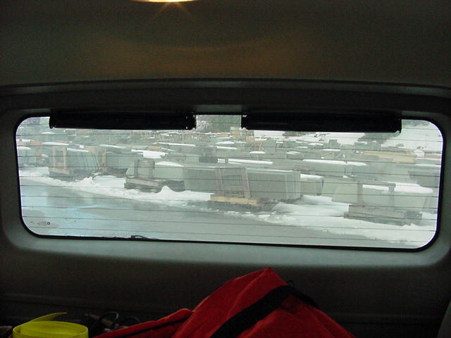

These are the LED bars on the rear door. This is the view looking from the inside-out. Like I said, I ran the wiring through the OEM boot and removed the stickers.

Another view of the rear LED with the door open. These measure about 16" long.

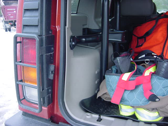

The speaker for the siren is mounted on the passenger side of the wheel well.

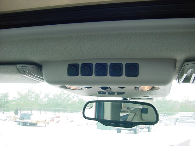

The main switch panel is located on the console. The first 4 control the strobes and LED's. The 5th one is hard wired to the siren control box. This is so I can just flip the switch and the siren comes on. No playing around with multiple switches and an ugly control box. The box is modified and tucked up under the dash(cannot be seen!!).

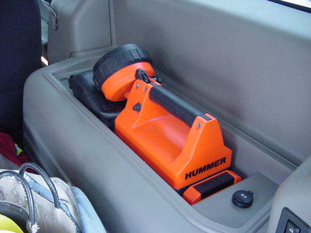

Here is my flash light, with base charger. It is mounted in the passenger side rear pocket. Power is taken from the rear cig. plug.

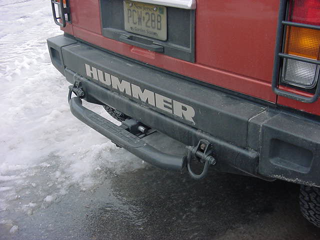

Off topic pic...here is a Go Rhino black powdercoated rear step. Great for washing truck and backing into people

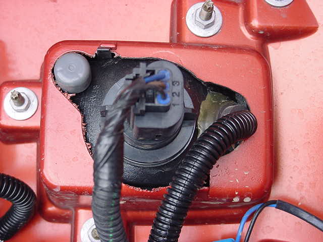

Here is a sample of the hide-away strobe mount. This is the front parking light. All wires in the install are loomed and all connections have dielectric grease. Also, the strobes have been sealed again with silicon to prevent any moisture in the lense.
