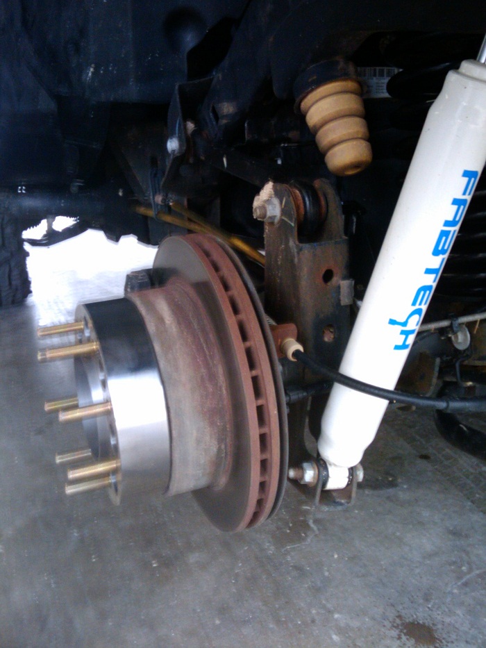

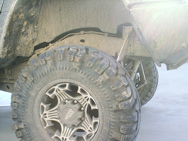

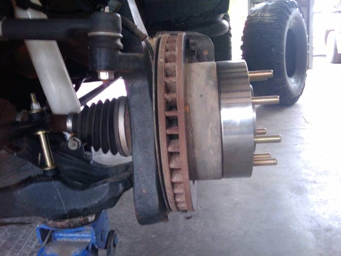

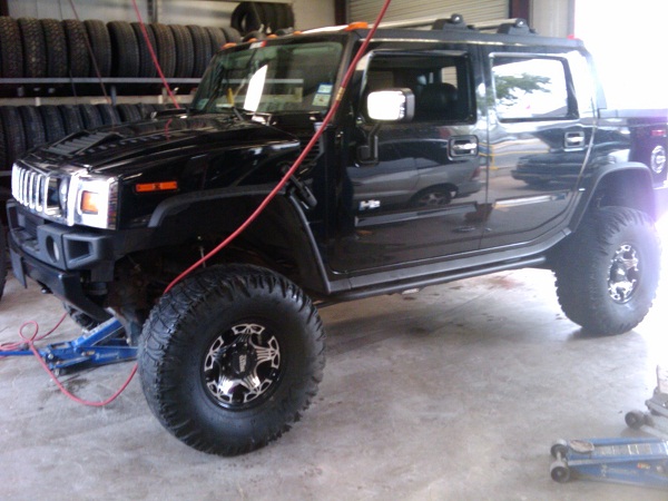

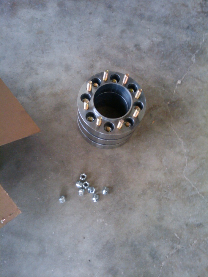

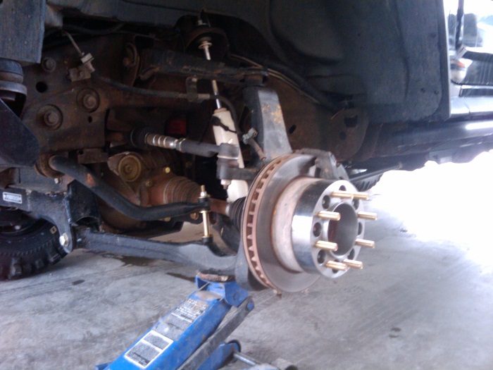

so its finnaly done!! 39s with 2 inch spacers. the kick a$$ factor went through the roof!......just one problem. nobody around here can balance tires this big ...............so my next obstacle is driving 2 hours at 30mph to the off road shop.
