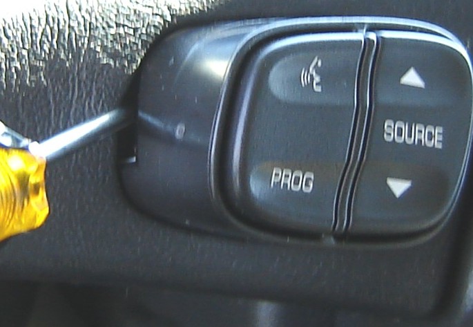

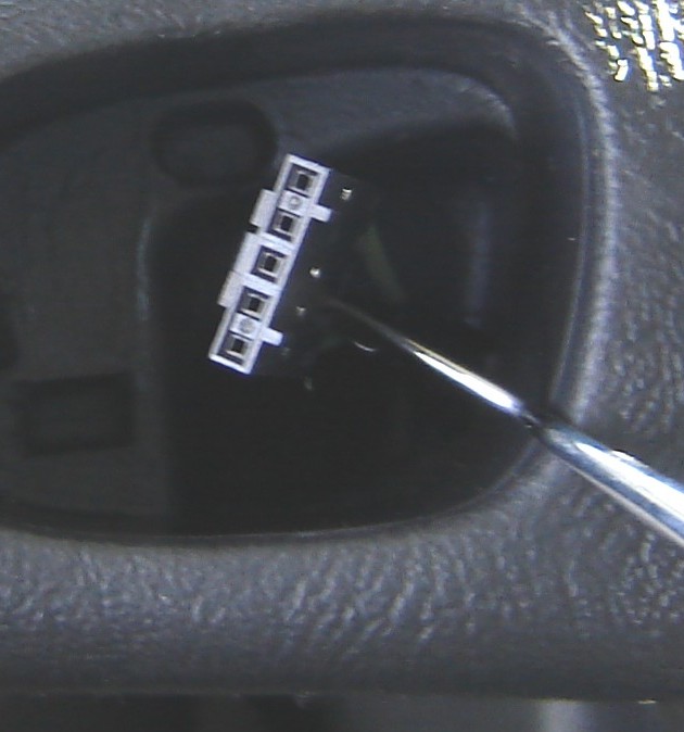

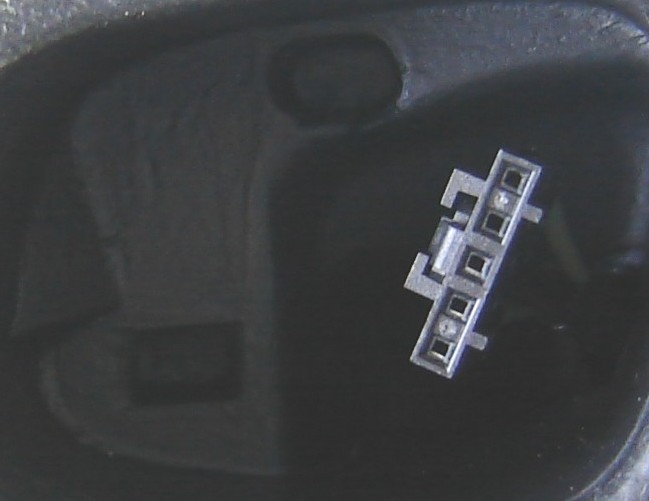

I recently had the same issue w/ 3 of my steering wheel controls on a 2004 H2. The light didn't work but the switch controls worked fine. I've attached a few pix, hope they help.
I don't believe that the bulbs in the switches can be replaced (but I'm not 100% sure). The whole switch needs to be replaced. The switch can be worked out of the hole it sits in without leaving any damage using a small screwdriver.
I had to use a type of "dental" tool to hold the connector in place while I plugged in the new switch. There wasn't enough slack on the wire to pull the connector all the way out of the hole (this was the hardest part).

They're LEDs not bulbs. Not designed to be replaced. However, if you have to replace the switch anyway; try it; you have nothing to lose. Chances are, the local radio shack will have the replacement LED for about 2 bucks, and a little time with a soldering iron might be fun.

After I got the switch out, I realized that I couldn't hold onto to the connector and plug the new switch back in (after about 10-15 minutes of trying).
The key to this (for me anyway), is to get some sort of tool that's skinny enough w/a hook on the end to carefully hold the back of the connector steady. That made plugging in the new switch possible. You may luck out & the wiring harness in your steering wheel may have more slack than mine did.

I just replaced my switch set this week after seeing the post here. The program switch was worn and the light was out on the source switch side.
The dealership charged me $23 for the part and it took all of 2 minutes to swap. The harness with the plug was short on mine so I used a small flat blade screwdriver to position the plug while getting it to click.

If you know how to take the air bag and steering wheel off, that is the way to go to replace the switches. Once the wheel is off, remove the plastic trim around the base of the wheel and you than can move the wire harness to the far right and the far left which will give you more sveral inches of play in the wiring so you do not have the issue of trying to get the wire harness plug into the switch. Another thing to be very careful of is DO NOT PRY against the steering wheel when pulling the switch out. The surround around the switch is foam and I have seen some of these actually split open when someone tries to pry the switch out. You can use needle nose pliers and pull the switch up by the little tab that sticks up betwwn the buttons when both buttons on the switch are depreseed down at the same time.
