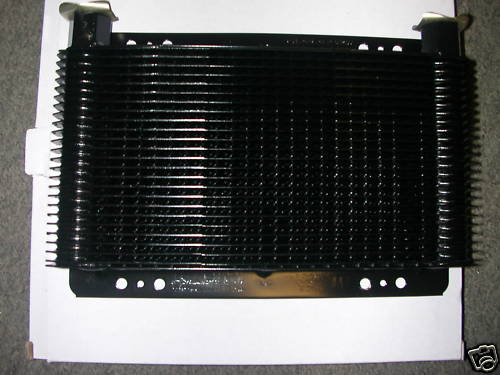

Default Re: need help buying parts
yeah it's true, the eom springs are great ...
what else to do guys, i'm looking for a cooler .. but don't know what to buy .. weather in my country is hot, maximum temp in summer is 140F minimum temp in winter 40F .. there's no snow .. so what the best cooler for my ride? do i need a thermostat?
2003 Pewter H2
- BFG's, Electric fans, Coil spring, Magnaflow Muffler, Xenon HID.
Old 09-23-2010, 01:15 AM
twr's Avatar
twr twr is offline
Join Date: Jul 2009
Location: ontario
Posts: 780
Hi this is the best style to get and as big as you can fit in. Also you want to leave the rad cooler still hooked up and you don't need a thermostat with the temps where you live.
