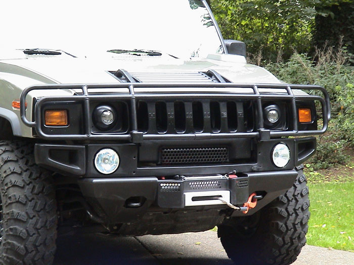

If you want the HIDs that I put in(which I'm still amazed at) call Sean in Hummer parts at (360)256-5000.
They're relatively simple to put in. They took me just over an hour to install.
I had the chrome bezels bead blasted and powdercoated black(because chrome sucks).

Ya, saw those, they work well eh? I don't know, they kinda give me the creeps. Looks like the rig is looking directly at me in that picture, even when I try and sneak up on my monitor *shudder*

Awesome driveway picture!! Us real off-roaders never take pictures on pavement!

I think they retail for around $900, but grind Sean on the price. I got a good price out of him, but I also buy all kinds of stuff from him.
Chrome... nevermind.
<BLOCKQUOTE class="ip-ubbcode-quote"><font size="-1">quote:</font><HR>Originally posted by NuckinFuts:
Awesome driveway picture!! Us real off-roaders never take pictures on pavement! <HR></BLOCKQUOTE>
**cough**asswipe**coughcough**
This isn't my introductory picture, you taint biter.
Even though you kind of begged for it() wasn't I complimentary of you not posting the offending driveway pics with the usual "Hi guys!! I just got my new H2 and I'm so excited!!! Doesn't it look sweet in my driveway?"
