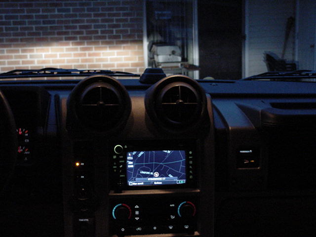

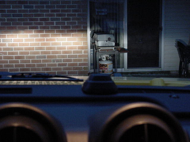

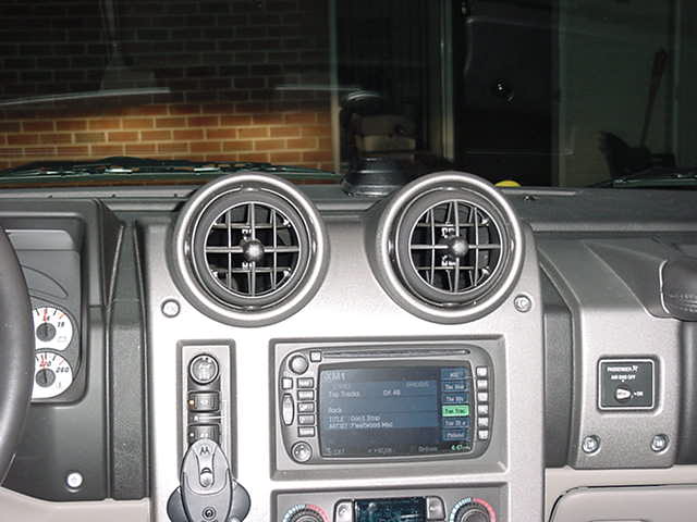

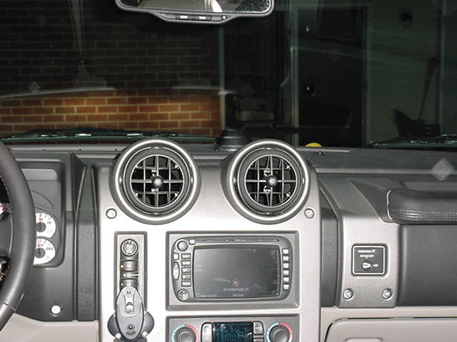

i just installed the kit on my 03 with sunroof.i mounted the antenna in tne center of the dash. and it works great. no need to drill holes in my roof.

Got any pics of this install? I'd be real interested in seeing this. Do you have a Nav system? I'm installing the TNR Nav system and XM this weekend but the Nav antenna goes under the dash and wondering if this would be a signal conflict.

yes i do have the nav system.the xm antenna is just to the right of the center of dash it covers a half an inch of the defroster outlet this is where i routed the antenna lead down into the radio cavity.i used 3m velcro to hold it to the dash and cut 3 of the defroster slats out so there was no need to drill holes. i'll try to take a couple of pictures but it's dark when i get home and it's also 18 degrees out.

1

2

3

4

Hey thanks Intimidator. Good looking install. Bet it's too cold to use that BBQ!
Jonahs
Old 12-29-2004, 08:28 PM
intimidator intimidator is offline
Join Date: Aug 2004
Location: west chester pa.
Posts: 97
intimidator is off the scale
probobly thats not mine. the trucks facing the neighbors house. i couldn't cook to save my lfe. lol
