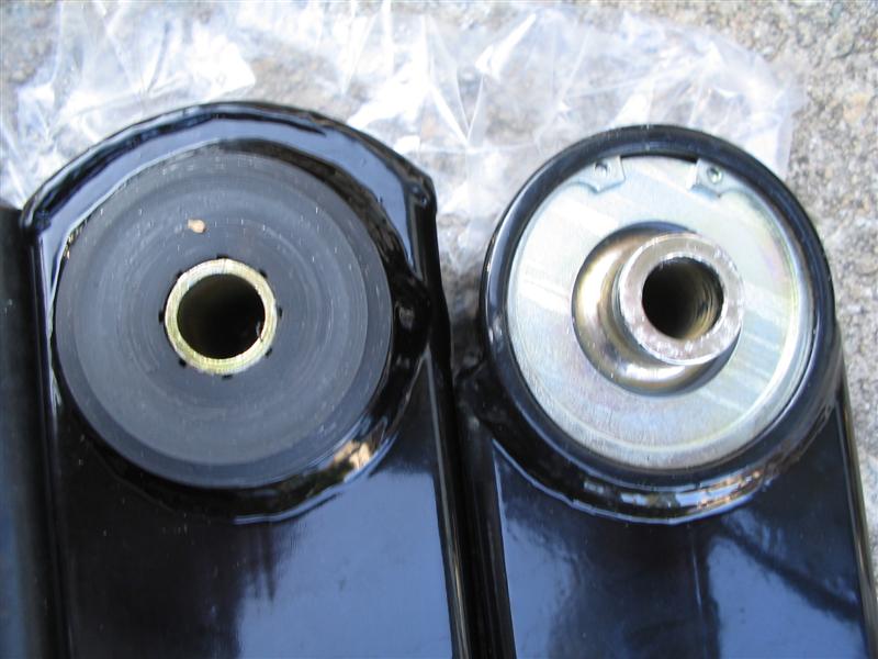

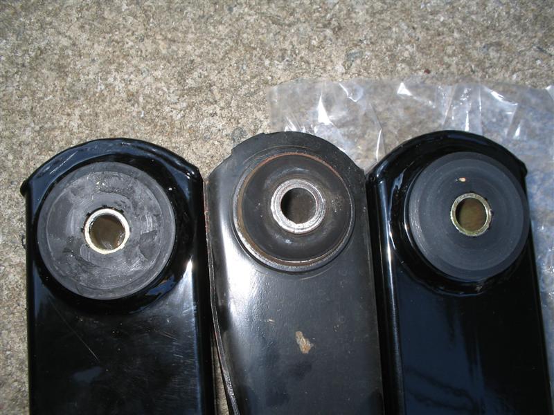

I spent this afternoon attempting to install my Edelbrock trailing arms. Unfortunately, there is a problem with them that kept me from installing them.
The front steel bushing is way too thin (and a little too short). I never could get the front bolt tight, and it actually bent the frame inward. The bushing actually tried to punch through the frame, as it was too thin. Keep in mind the torque spec is 140 ft-lbs!
Factory part is in the center.

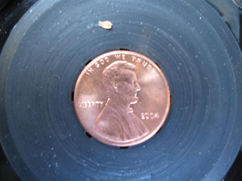

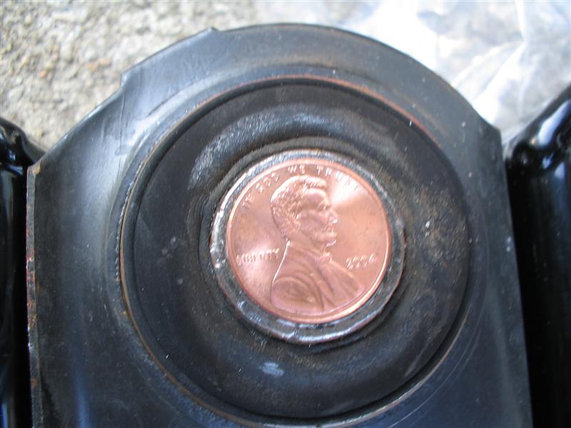

Posts: 2,511
Penny does not cover up factory bushing.

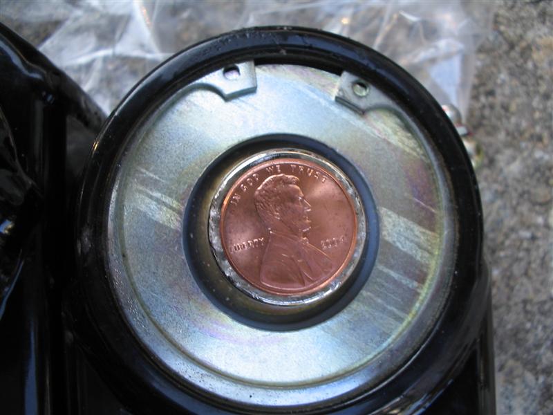

Posts: 2,511
Penny is larger than Edelbrock bushing.

Posts: 2,511
Interestingly, the rear bushing on the Edelbrocks are the correct thickness.

Posts: 2,511
Comparison of Edelbrock front and rear bushings.

Klaus,
Was there no "washers" or other "adapter" that goes between the bushing and the frame. The rubber part of the bushing would be binding on the metal frame and most you'll see some time of flange sticking out further than the rubber/polyurethane bushings and you torque against metal only.
Did the stock ones have some type of insert, flange or washer with them that you can use?

Paragon,
There are no washers or adapters on the stock units, and none came with the Edelbrocks.
