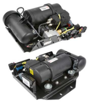

I have ordered springs to make the conversion BUT they will not be here for 7 days. I was wanting to put in a T connection so I can fill the airbags manually from the air fitting in the back cargo area. Anyone done this?
After I do the conversion I would like to put some sort of compressor in place of the OEM unit so that I can use the air fitting again. having an onboard air compressor is darn convenient! Has Anyone tried to rebuild their compressor? Scot

I have fitted a T converter under the truck since my compressor broke and I have been running like this for more than 1 year, works without problems.
Just pull the compressor out there will be 3 hoses left connect them all together and you are done.
After pulling the compressor it's a 5 min job. But the tricky part can be to loosien the hoses from the compressor, there is a thread about it somewhere here.
