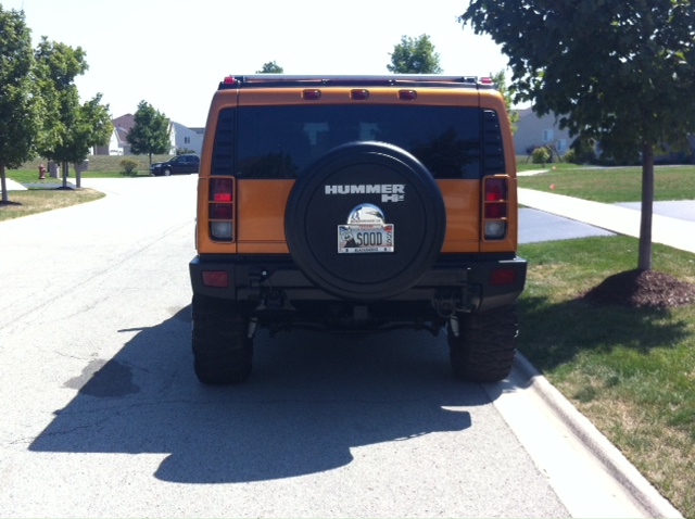

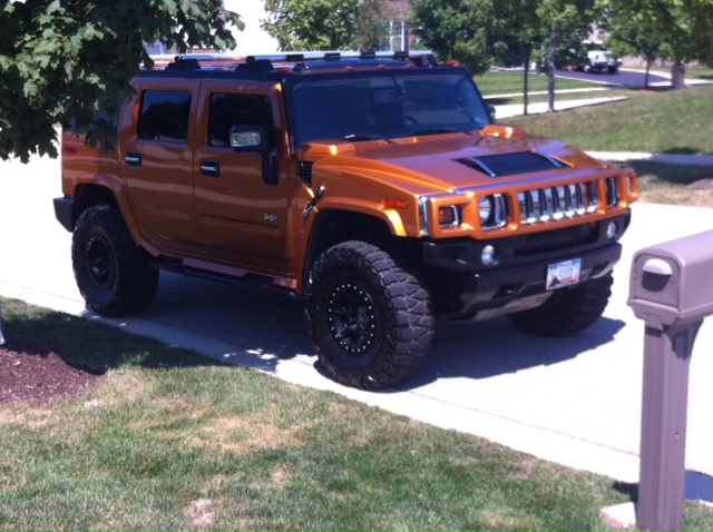

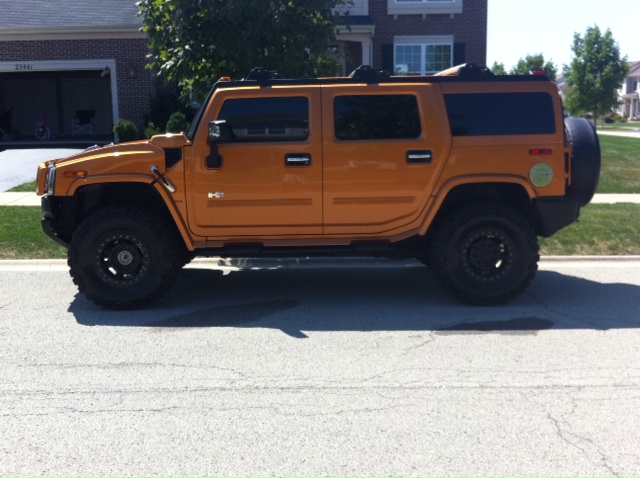

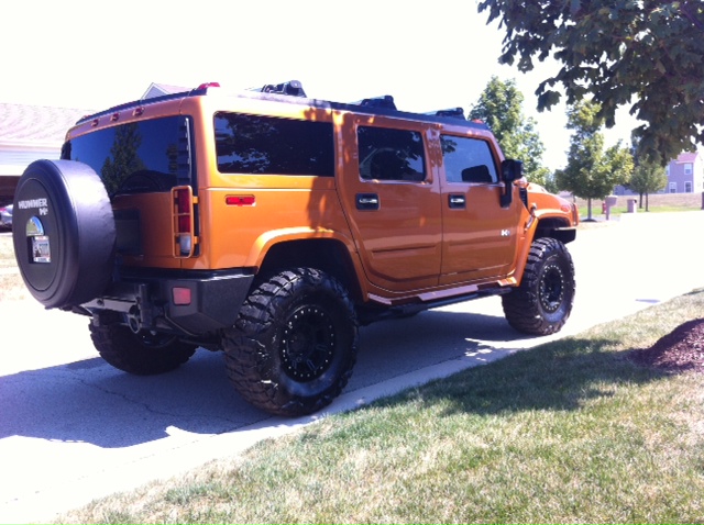

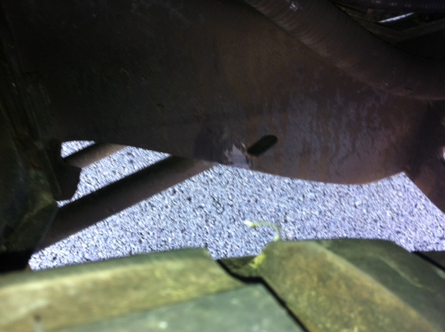

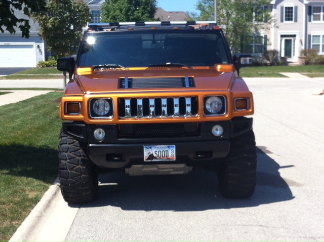

some pics of my new truck(to me) and the prob areas.

Can't really see **** from your pics where you are rubbing and how much.

Thanks for all the help guys. I have rear bags and it rubs everytime i go over a bump. As far as the fronts they rub every turn i make i.e. normal right turn and normal left turn. i am willing to go to a new wheel with the correct back spacing needed. You guys think that will fix the prob? the wheel i would like to use is called the double standard can be found at....
