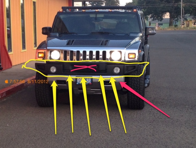

Old 08-16-2012, 03:03 AM
pdxrealtor's Avatar
pdxrealtor pdxrealtor is offline
Join Date: Feb 2008
Location: Portland, OR
Posts: 948
pdxrealtor is on a distinguished road
Default Re: where to mount ballast!!!
No that piece snaps out (red x in my pic). Doing so is step one to removing the bumper.
Identified in my pic with a red x. Remove. It pulls straight out. No bolts or nuts to remove.
Identified in my pic by red arrow, remove. 2 bolts under car 2 bolts under plastic plugs located on piece in my pic outlined in yellow. The same piece that holds your fog lights.
Once red arrow is removed you'll see on the back side a row of 13 mm bolts. These are the yellow arrows in my pic This is how you separate yellow outlined piece from red arrow piece.
From there I don't have pics or details but it should be self explanatory on how to separate the yellow outlined piece.
Come to think of it, you can probably mount your other 4 ballasts in there. For a total of six. Let us know..... Maybe not. You loose a lot of space to red x piece.
