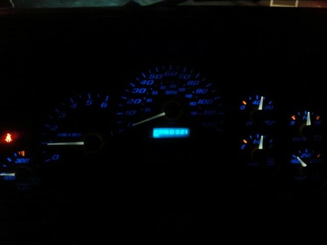

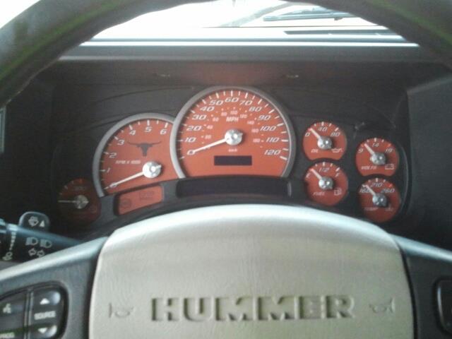

My tach motor went out and I had it (just the motor) replaced. While it was apart I had new LED bulbs, new white needles, and a custom UT Longhorn insert put in. Pretty nice set up IMO...Insert has blue film settings, so the white LEDs actually appear to be blue. Sorry about the night shot, kinda fuzzy, but you get the idea. $200 for the whole shabang!

I didn't buy a full cluster just the overlay. I actually had enough white LED's left over from my other projects to swap out my cluster bulbs with white LED. The escalade overlay has blue lenses that's why you see a bluish color.
