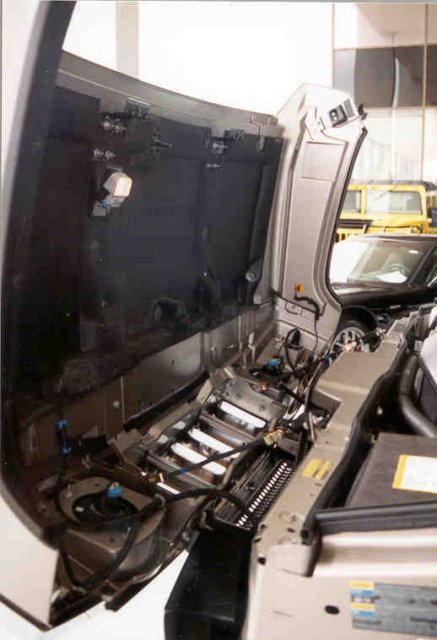

I may take my old DRL's and stick them under the hood with a switch.
Actually, the early H2's had a hood light in the center of the hood, see pic. That's GM...saving the big bucks and taking away our everyday conveniences.

I have two lights under my hood .... one like in the photo and another down near the bottom of the oil dip stick mounted somewhere either on the frame or on a support of some sort ... I have a very early H2 .. #146
