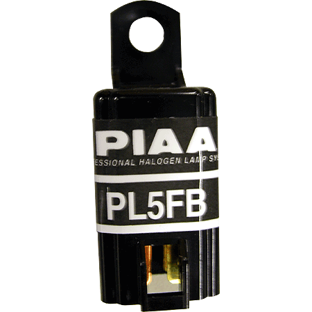

Anyone know where I can get the connector that hooks these two up at?
It for the PIAA lights that came with my new h2

When you say "these two" are you referring to the 2 white connectors and mating them to one another???? If that's the case just cut the connectors and match the wires to their counterparts on the opposite end.
On the other hand, (based on the pic provided) the connector is showing 4 openings that would lead me to believe that those were connected to some kind/type of relay (as shown below) so when you turned the switch on, the relay closed the circuit and the lights came on. Have you looked at the PIAA website or gave them a call to ask about their wiring??
Lastly, use a meter and test/check the wires to see what goes where.

Yes, I was referring to the white connectors, but what you said about the relay makes lots more sense.

the 4 connectors (if it is a relay connection) would work as follows:
one to the power the relay
one to ground the relay
one to the switch
one to the accessory (light)
Being that there are the 4 outlets and how they are arranged/configured (all horizontal & side by side), leads me to believe its a relay connector. The other "clue" is that its square and PIAA has a square relay unit.

It is indeed a relay that is missing. Confirmed by PIAA
