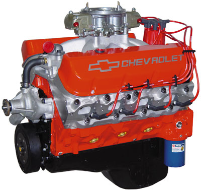

Here's what you really want:
Turn Key ZZ572/620, 620 HP 572 Street/Strip Crate Engine
620 horsepower from a 572 ci crate engine. The new ZZ572/620 is built around an all new Gen VI tall deck Bow Tie cylinder block. This all new race block is filled with a forged 4340 steel 4.375 in stroke crankshaft, 4340 steel H-beam rods, and forged aluminum pistons with full floating wrist pins. Plasma moly piston rings are standard as is the screened and louvered windage tray. Hard core race parts for hard core performance and long term reliability.
This turn key engine package includes a single plane intake manifold, 850cfm Demon carburetor, HEI ignition with plugs and wires, aluminum short style water pump, harmonic balancer and a flexplate.
So what are you waiting for? Go ahead and buy the engine you have been dreaming of and put your car in the front of the pack.
Horsepower: 620 @ 5500 RPM
Torque: 650 @ 4500 RPM
Max. RPM: 6000 RPM
Compression: 9.6:1
Block: Sportsman Tall Deck Bow Tie
Bore: 4.560"
Stroke: 4.375"
Crankshaft: Forged 4340 Steel
Camshaft: Hydraulic Roller, 0.632/0.632
Intake Manifold: Aluminum Single Plane, 4150
