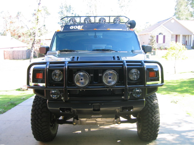

Maybe someone with more electrical experience can help me as well. I have (4) PIAA 520's,(2) Hella Rallye 4000's, and (2) PIAA 60XT to wire (I already wired the one set of PIAA 525's). The shop I took it to told me that I will have to have the alternator upgraded (about $125.00 they said), and run a seperate battery setup to run all of these lights. Is this correct?
Thanks,
-Justyn
05\' Black SUT
Old 02-28-2005, 06:27 PM
I don't know what the amp draw would be for those, but I find it hard to believe that it would be more than a winch and you use the winch a lot of the time at 500-600 RPM.
With the lights on you are usually moving so it would stand to reason that your RPMs would be higher. And so on and so on. I just don't think it is very accurate for them to make such a blanket statement. Sounds like they just want to make a few more coins and it obviously wouldn't hurt to have a bigger alternator and a second battery.
