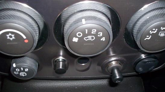

Thanks f5fstop I thought I read they went off.
figured you were right I havent heard of you being wrong yet.
I guess I have to tap in a rap circuit maybee put a 12 outlet under seat on that metal plate.Does the harness underneath the seat have a rap circuit ?
Im suprised they put my lighter in the left port if the right one is higher amp

I guess the right socket is 30 amps because it also runs the cargo one.
