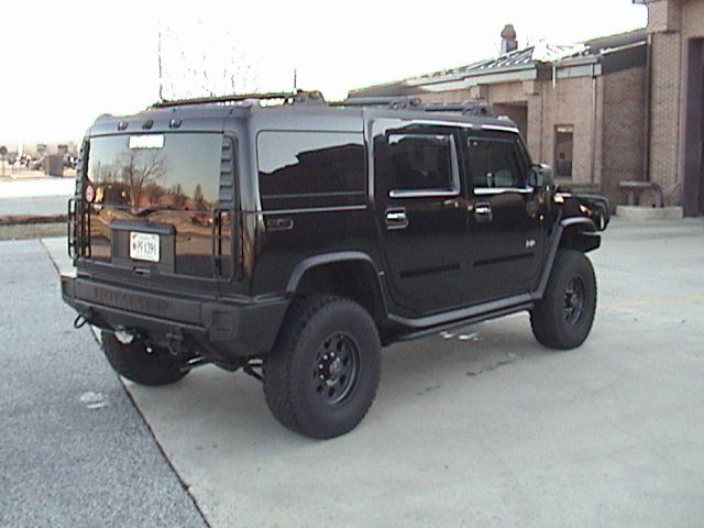

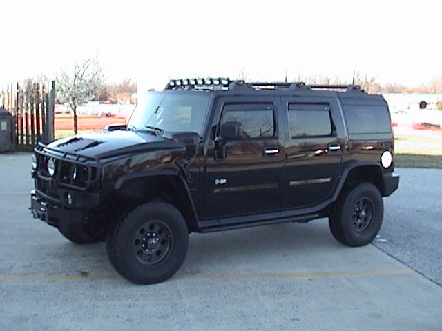

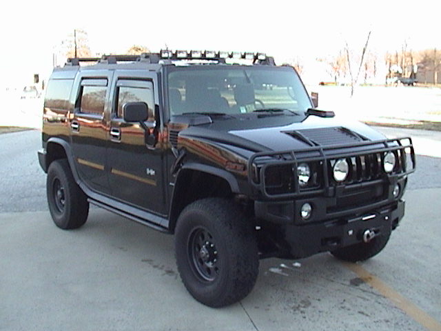

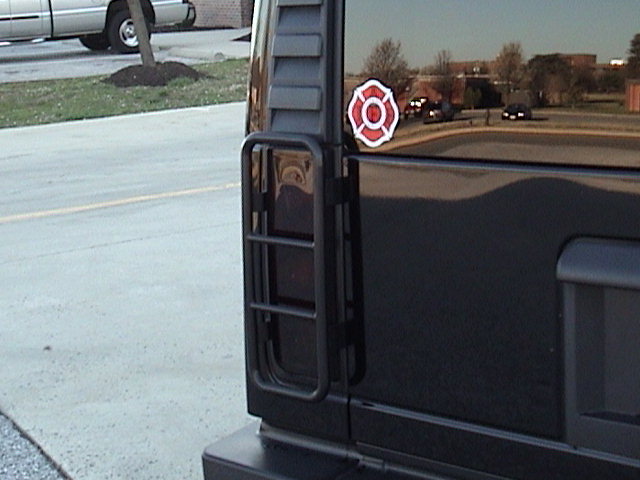

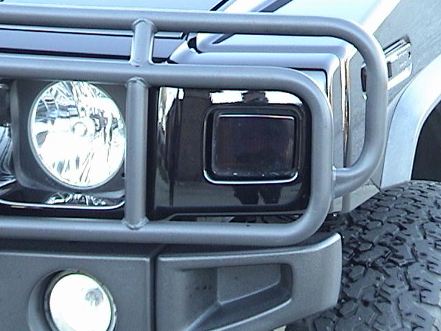

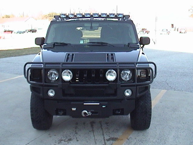

Heres the newest mod a buddy of mine blacked out the turn signals, rear lights, and the side markers.

since you blacked everything out.. almost.... you need to tint your windows and get a bleck chrome gas door...
Old 03-16-2006, 04:37 PM
Looks great FJ....now just do the gas cap and door handles!
Old 03-16-2006, 04:49 PM
Looks great Jay!
LMAO at the custom bling chrome fuel door. That was the first thing I noticed to.

Thanks for postin the pics fireman, i like it! what size rim and tire you got on there? and i agree with twenty2 and ddwh that you need a black fuel door next. also, i put a black and orange IAFF sticker on the back of mine, i think it looks pretty good. i'll try and get some pics of it. it doesn't contrast the vehicle so much.

i,m still tryin to figur out how to remove the fuel door it was on the beast when i got it as for the door handles they will be done soon enough.

i think the fuel door is held on by double sided tape not sure though.
but it does stick out bad

saleen they are stock tires and the rims are these.
http://www.wheelsforless.com/search_...duct_ID=398178
they are the ones at the bottom of the page and the price is better now than when i bought them
my cost was 975.00 delivered. it was a good company to deal with when they arrived they were 1 set of lug nuts short and 3 of the 4 center caps were broken due to shipping they sent a RMA (return merchandise authorization) call tag with the new caps and a whole set of lug nuts for all 4 wheels. cant say enough good things about there customer service.

That one is screwed into your filler neck bezel on the truck. open the fuel door, unscrew your gas cap. You'll see two bolts in there. remove those and than turn counter the whole assembly clockwise while pulling out away from the truck. the body is slotted, so the filler neck bezel just has to get past those tabs and will fall out easily once turned. It may be tough to turn, but it will come loose. So you'll end of having the whole filler neck bezel and fuel door in one piece. look at the back side of the fuel door and you'll see some screws that trap the door onto the bezel. Remove those and install your black fuel door.
If this doesn't sound easy, just send me a PM, and I can fax you some dirrections.

Tweny2 the windows have been smoked i know the pics are not the best but its the cam i have

Sweet!! Love the blacked out look.
But yeah those handles and fuel door have to go.
