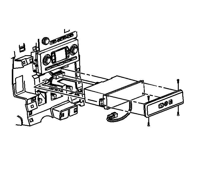

Anyone?
Pics/info on an ""easy"" take-out replacement of the On-Star unit? I'd just like to use it for a storage pocket/CB pocket or something simple.

Ric,
I'm not sure what you are asking. The OnStar unit is an assembly that can be removed.
Disconnect the battery, slide the console back, remove the dash panel, and the whole OnStar unit comes out with a couple of screws. Unplug the wiring connectors and GPS antenna.
Beware that the "pocket" is kind of shallow. There is a plastic brace in the back that supports the rear of the OnStar assembly. I had to cut this brace out to install my GM CD Changer.

Hey Klaus:
Thanks for the simple removal instructions...now to finish the job, how to make it a useable pocket/hole...don't need to add a cd/cb/?...for now, just some kind of plactic insert to make it a storage slot or Kleenex holder :-), or tie rod replacement kit storage, or ??? :-)

Ric,
I agree with Klaus, there is not much there but you might be able to remove the face plate off of the onstar "box" and use the "box" itself. I'm not sure if the front of it is open or not.
