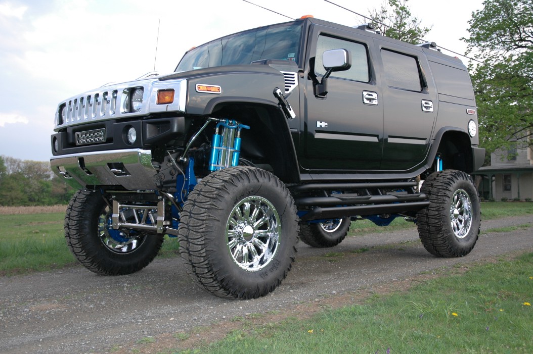

My Black H2 has the BP 12" with chrome and powdercoating. It has shi..ty tires right now. I need the Toyo MT's---same as on the Pink Hummer but they are $3100.00---waiting for a Toyo sponsorship that is in negotiation--then I will get them. Toyo's 40 x 15.5 x 20 or 22 are the only tires to have with a big lift.
Also the tires on it now are only 14.0 wide and too thin for the height of the Hummer.
They were not available when I did the Black so I have bias Trxus---they are worthless on this Hummer because you need a radial not a bias tire.

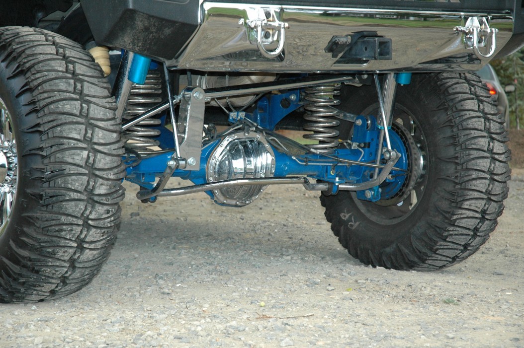

Rear of Hummer--BTW VIP does not make lift kits so they will never have a 6".
This H2 will be at HGW night on April 15 in NJ. The flyer on here got deleted.
My Yellow will be in Nashville for the ARCA and Busch races.

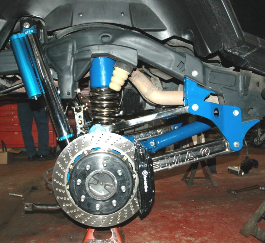

On the 12" kit, both driveshafts have to be lenghtened. On the 6" kit, neither have to be lenghtened--just a new CV joint installed up front.
Where do you live? If in CA, no doubt that VIP can do the job. Manny has been doing these lifts a long time. From the work I have seen, they do it well.
You can maintain the origional trailing arms but I would not do so. I like to stiffen them when over 6" in height.
I like the SMA ones but they are gone. We still use them, grabbing them where we can and then we will have them made. Other companies make good trailing arms too.
FTS makes a great kit--have one on my Yellow H2---I like the service at BP better, that's all.
I like the FTS anti compression struts and use them with the BP kit. I also use their tubular track bar, which is very strong and sharp looking as well.
More later on what is included in the kit. Note that I use King shocks with 1" diameter shafts and 2.5" cans, not the Fox Shock sticks that are offered with the base kit.
In this pic, I also increased the diameter of the drivesahft since I had them made from scratch--the front one too.

Those TA's will work well with your lift.
