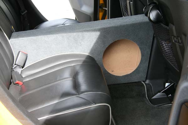

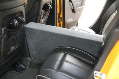

Thanks for all the help, I'm going to try doing the install this weekend, i had to order the OnStar adapter from Crutchfield's. I'm debating on ordering this subwoofer box (pictured below) and buying similar stock black cloth interior to wrap it so it matches the truck, let me know what you think. I mostly listen to classic rock, rock and a little country but i like a little clean bass.

Got the head unit installed with the GMOS-01 adapter, works great, SUPER EASY TO INSTALL!! My buddy that was helping me did put a scratch in the panel, so now i need to find someway to cover it or fix it... friends... lol. Still debating on the sub-box above. But i think the H3 is larger in the back than the T, so idk if the box would even work... might be too big seeing as its built for a regular H3.
