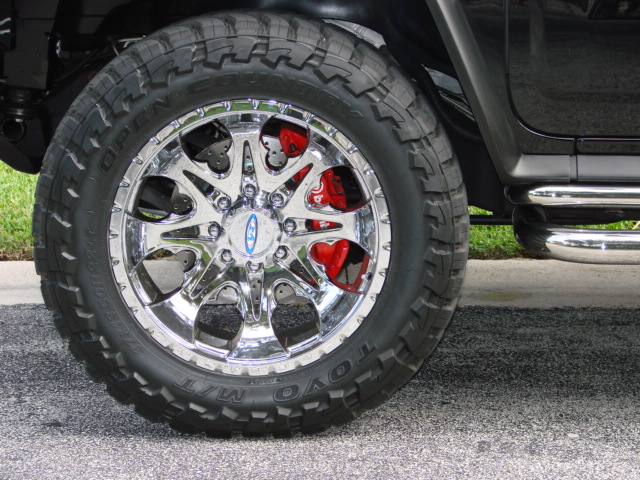

Well, after doing some research on the internet, I ended up getting Bembo's after all. I can't believe I spent the bucks on brakes, but the place I have been having work done, had a set of Gran Turismo's from last year so he gave me last years pricing which is significantly less that what these things are costing today..Must be making them out of gold today. 8 pistons in front, and 6 in rear. It definitely does stop you and very smoothly I must say. Anyway, I am very happy so far. A very noticible improvement over the originals. Went to beach this morning to take a picture or two and unfortunately the camera died (xxx*** batteries)after taking one picture at 5 megapixels which I can't post.. I will try again tomorrow. ps it also completes the tire, wheel look..

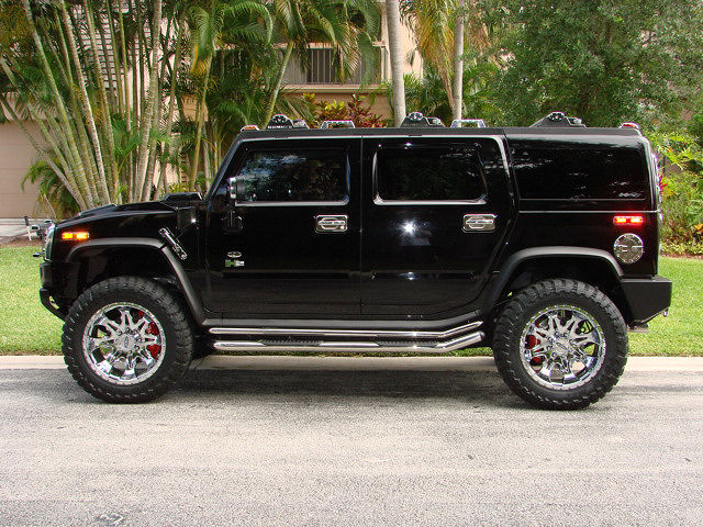

Finally got some new pics with the brakes..
