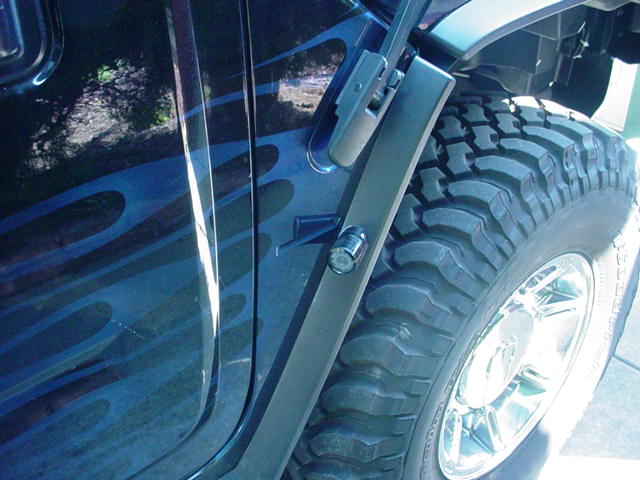

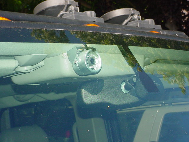

Front Camera

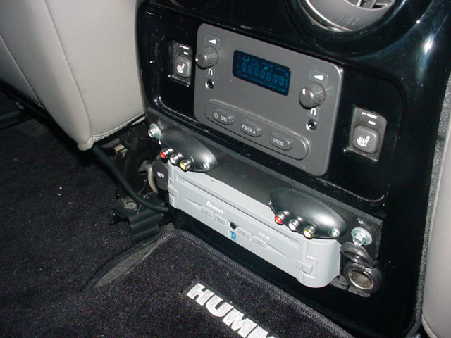

DVD Mounting

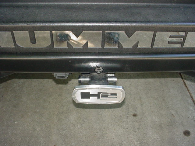

Rear Camera

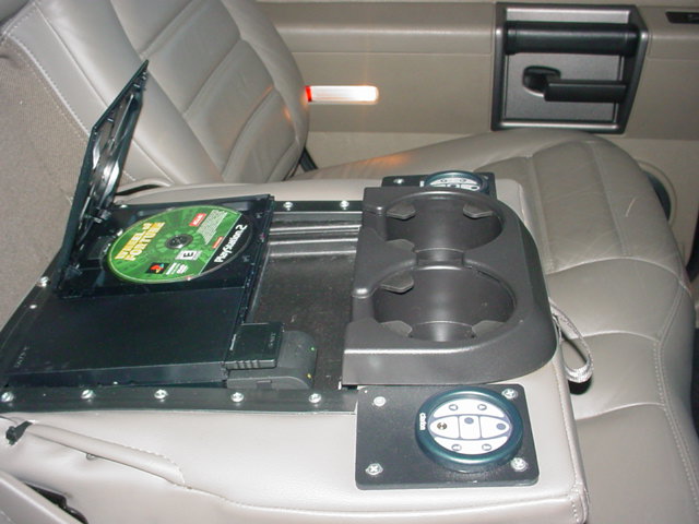

PS2 mounting with Multimedia Controllers

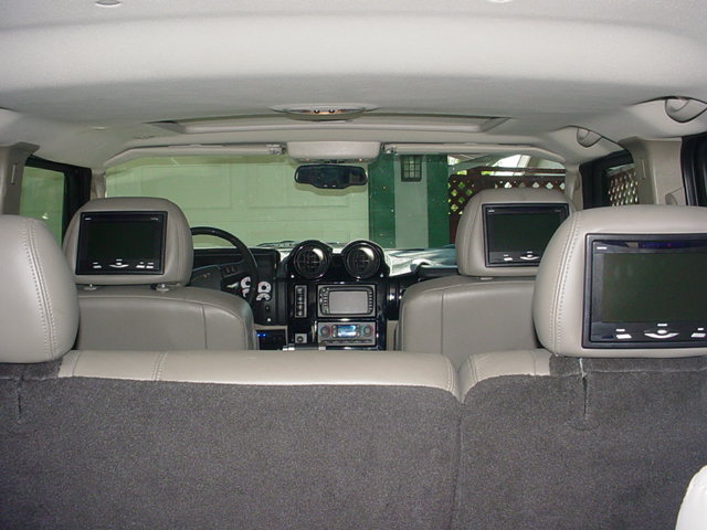

The screens

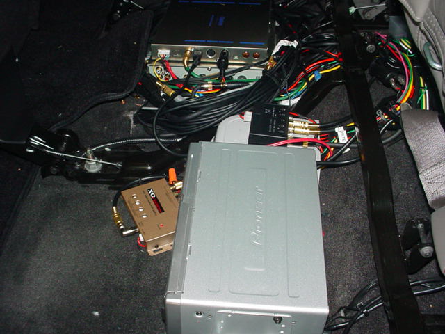

The brains of it all

Cool setup man nice appointments. That being said tho...
Holy crap those cameras are GINORMOUS! I used eclipse cameras they are so tiny.
Why would you need a front camera? Arent you looking forward?
Old 06-19-2005, 11:48 PM
passerby passerby is offline
Posts: 27
passerby is off the scale
The front camera is for the kids. Thet get hiding behind those monitors and sometimes they like to switch to the front camera to see where we are going. They seem to watch that more than play PS2. It is also the reason I think they fight over the front seat. They like to see where they are heading.
