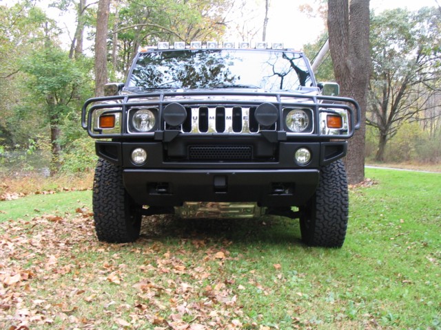

Definitely polish it, not chrome plate. Polishing is much cheaper and looks just like chrome. Chrome plating on aluminum doesn't work very well and it tends to flake off. Have Bright Lee polish it, it will cost about $160 plus the cost of shipping. He is on ebay and advertises on this website. He did mine, it looks great and has held up well so far. Here's a pic, but it looks just like his ad.

Thanks Big Jag. Looks AWESOME! Skid Plate so Bright, Gotta Wear SHADES!
