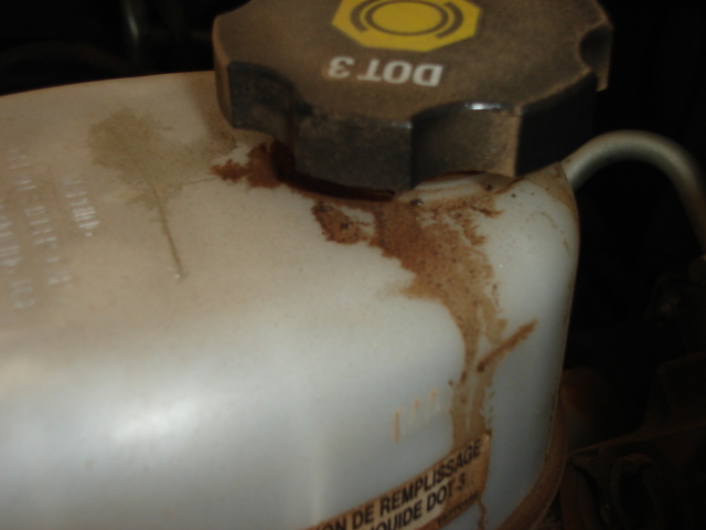

So I finally got off my ass and popped the hood. Took some pics of what I saw...I am taking it in to the dealer this week, but do you think this indicates the cap is not sealing tight? The cap didn't seem very toght, but I don't know what's normal on an H2. The level seemed fine.

So the tech at the dealer checked everything over, bled the lines, and we're back in business. Strong brakes again.
