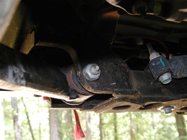

Old 05-02-2005, 04:04 PM
Took some pictures this morning. This is a picture of the bolt head. Remember this is the front of the driver's side lower control arm attaching to the frame member.

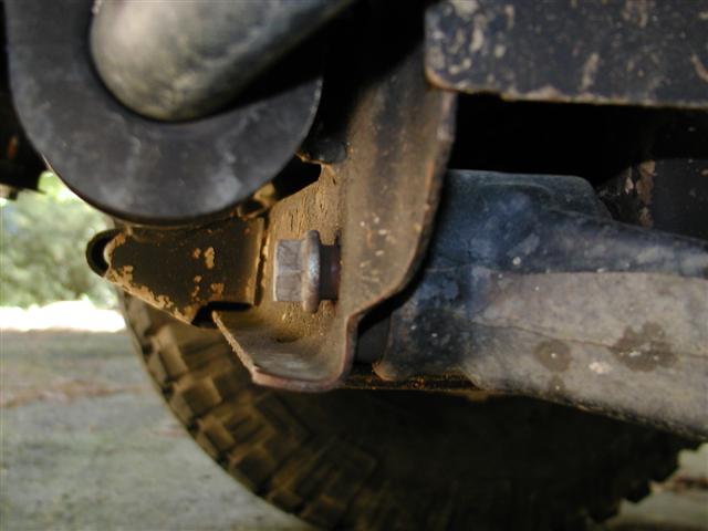

Old 05-02-2005, 04:05 PM
This is a picture of the nut and the threads that's on the back side of that bolt

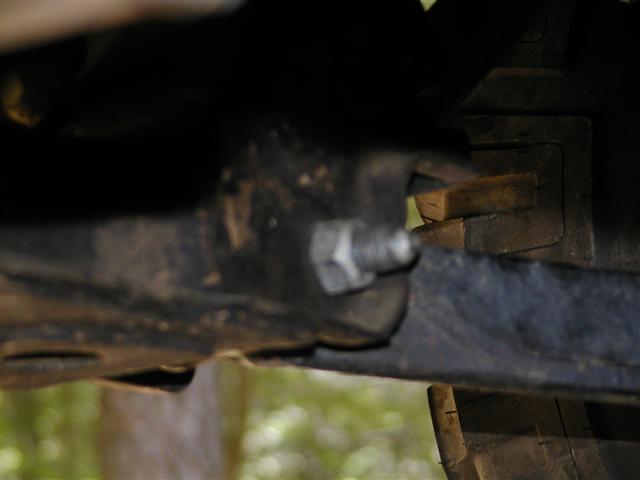

Old 05-02-2005, 04:06 PM
This is the picture of the passenger side nut and threads

Paragon...
It definitely needs to be tightened or better yet replaced with new bolt, nut and lock tight.
If it runs loose like it is it will wallow out the hole in the crossmember.

Old 05-02-2005, 06:28 PM
Don, come July it'll be 3 years old and I am wondering if it has been somewhat loose since and the damage might have already been done. I have had a nagging "slop" in the suspension that I have not been able to put my hand on, and still really can't knowing this.
This was one of the reasons I added shocks.
A good while back I had the PS torsion bar replaced. During that time I was telling the service tech about the "slop." While travelling at speed, it's like when the front gets light over a bump that bolt has slack in it and there is the slightest little chatter. It doesn't happen every time over the same bumps so it's been hard to pin down. It also hasn't been so bad as to be a problem but I am wondering if this bolt provides enough slack for me to really be feeling what I think I am feeling. Ya feel me?

Hummie2 is an unknown quantity at this point
If the bolt hole wallows out or wears sloppy you will have hell keeping the frontend aligned. It will let the lower control arm move around. Have the tech check idler and pitman arms too if you have play or road wander also. Three years and they might be worn out especially if you wheel very hard often.
