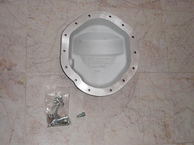

? Iam changing diff covers and I need to get new gear oil of course. I was going to go with Royal Purple Gear Max but i didnt know what weight to go with. The lady at the shop said that 75-90? was the more common. I dont know gears and oil if my life depended on it.. Any sugestions? I need a good synthetic oil and the purple i heard to be the best.

awesome thanks guys.. so when i bolt it back up i bolt the whole thing and then where is the filler hole? i know iam a retard first timer here!

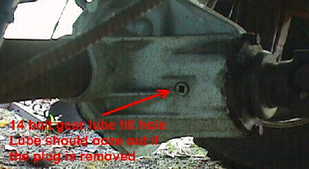

It looks like the fill hole on Phils is on the side.

my cover does not have any drain or fill holes.. is there a spot on top of the dif case? also how fill should these be? completely?

<BLOCKQUOTE class="ip-ubbcode-quote"><div class="ip-ubbcode-quote-title">quote:</div><div class="ip-ubbcode-quote-content">my cover does not have any drain or fill holes.. </div></BLOCKQUOTE>
I guess you will have to put the oil in and slap the cover on real quick .
Seriously though, that sucks .

The manual says the rear diff only holds 4 pints, but that just doesn't seem right. I put in 7.5 pints with a new diff cover. </div></BLOCKQUOTE>Ok, a little wierdosity here. Phil, I just looked at the service CD and the '03 ballpark capacity is listed at 4 pints, but the '04 and '05 says 2.75 quarts. Maybe there was a change to the chunk or to the cover between '03 and '04 and your cover is more like the '04/'05 one.
DH, you really need a cover that is designed for the the H2. The fill plug is also the check plug, so without it there is no way to see how much oil is in your differential.

I would send it back if it doesn't have a fill hole.

Uh, I must be wrong in my thinking as far as capacity goes. I was under the impression that if the fill hole is on the side you fill the diff to that point. That way you can't overfill it. The overfill just flows back out. So if that is true and the filler is on the side, just go buy 6 pints and return the left over.

<BLOCKQUOTE class="ip-ubbcode-quote"><div class="ip-ubbcode-quote-title">quote:</div><div class="ip-ubbcode-quote-content">Originally posted by sfox:
Isn't the drain hole shown in ths pic? </div></BLOCKQUOTE>I thought there was one on the housing. Now Phil has TWO cloaca.
Old 03-03-2005, 05:54 PM
Are you sure there is no fill hole on the other side? This is a different GM diff, but they seem to be consistant on some things:
http://www.off-road.com/chevy/projects/kickin/pml/
And here is a pic a different one, still:
