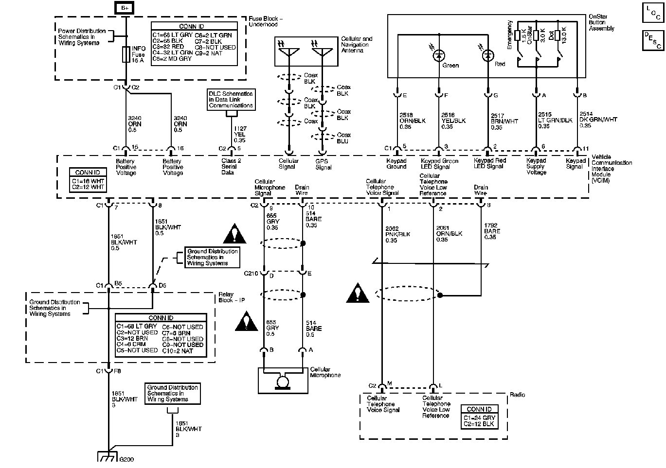

Hmmm... Maybe they changed something during the 2003 build year. I have an early build (10/2002), and pulling the info fuse alone killed the OnStar.
Glad you got it working.

FYI - OnStar Schematics.
