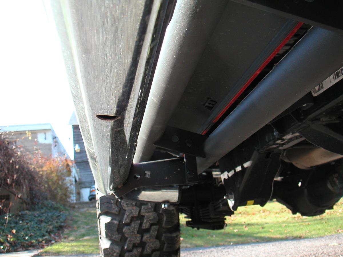

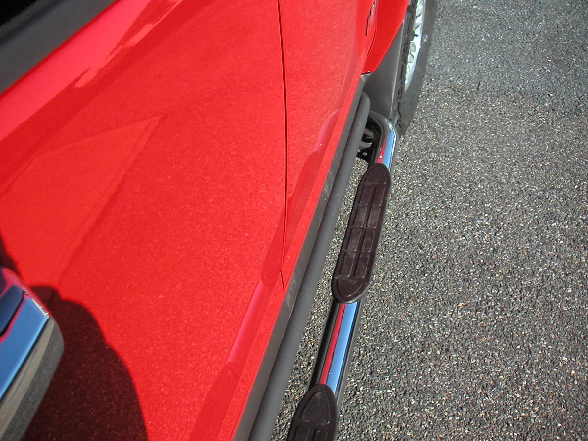

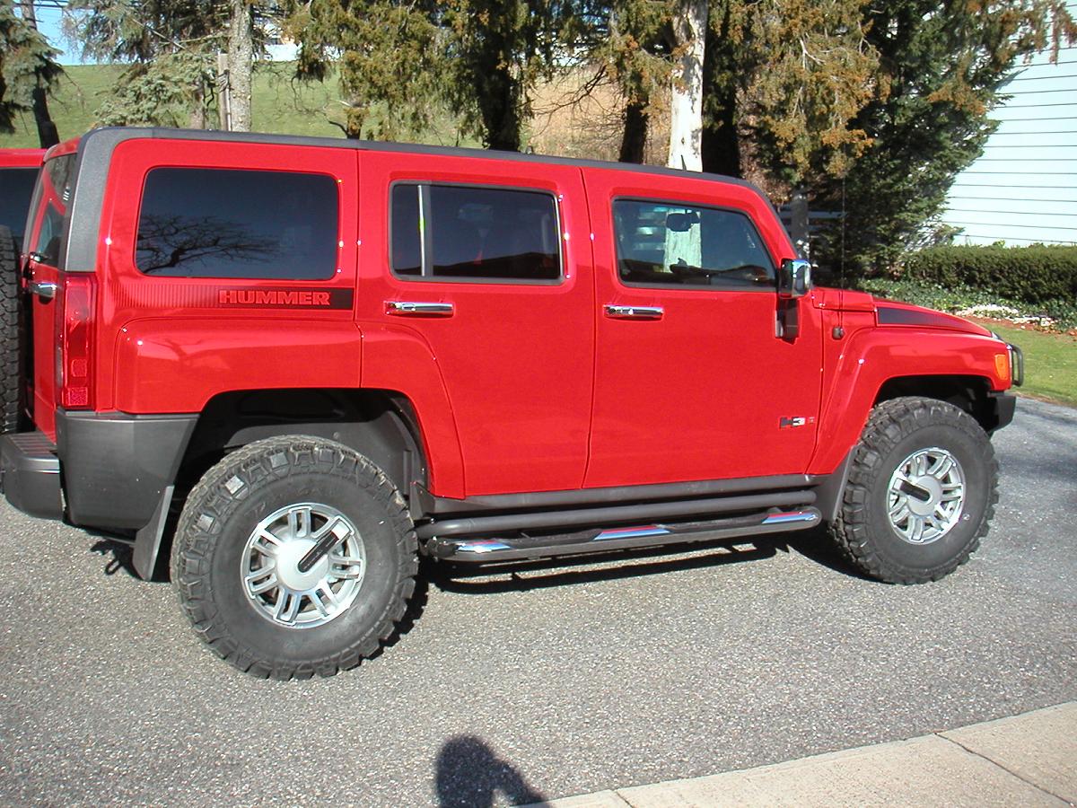

Rock bars and steps. Its not that hard to do. 4 bolts and its off.

Looks good, can you get a picture of the bracket underneath? OOPS, I just found them in the pictures, Thanks

Very cool I will want both myself. Will have to look at the other pics.

- looks great, so what's the height clearance with both? I will do the same. thanks for the pics.

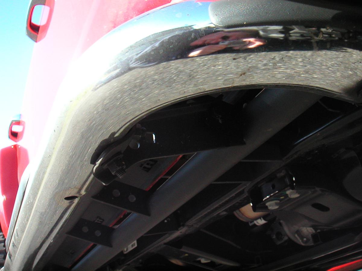

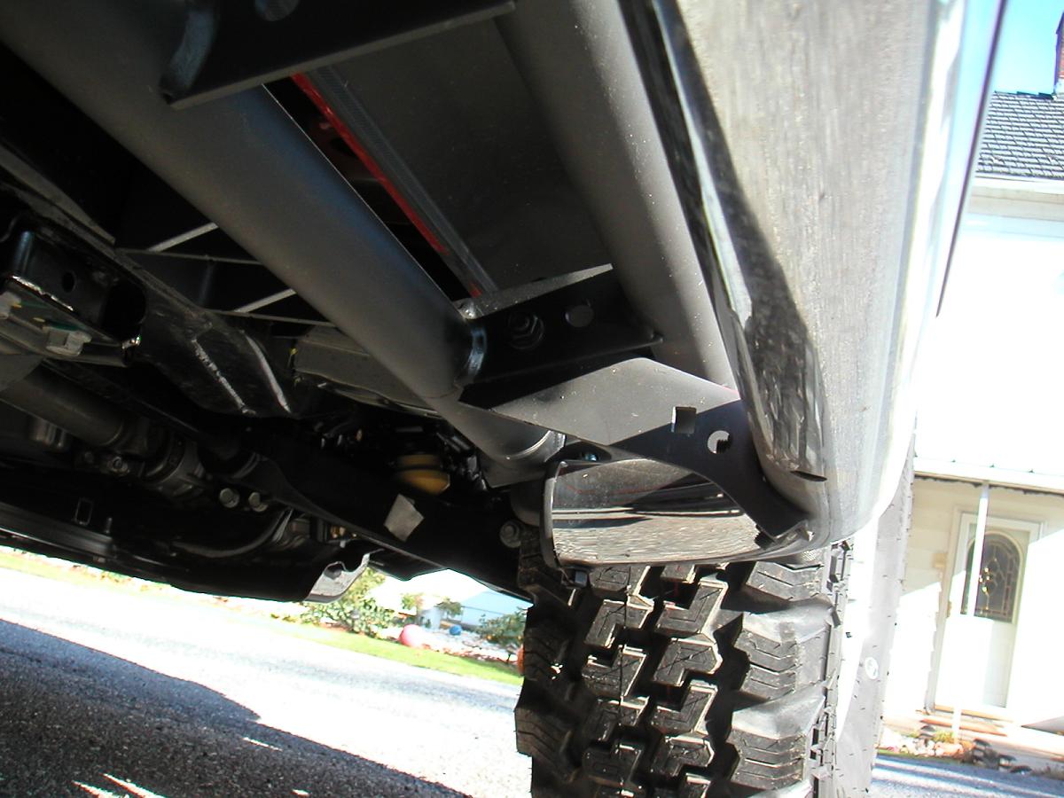

Posts: 101
Bracket pics.
11-20-2005, 06:07 PM
Posts: 101
more
11-20-2005, 06:08 PM
Posts: 101
and more

Ground clearance to the bottom of the step bar is 13-14 inches

Here, mee do.....
<BLOCKQUOTE class="ip-ubbcode-quote"><div class="ip-ubbcode-quote-title">quote:</div><div class="ip-ubbcode-quote-content"> quote:
Originally posted by tmiller:
Just take the mounting bracket and cut the end off that mounts to the frame and redrill the holes in the tube step that mounts the bracket
To tilt it up to the rock bar piece that has 2 holes in it . Drill the bracket to line up with one of the holes in the rock bar and bolt it. That is for the front bracket.
The back bracket you do the same but add an aprox. 3 inch piece of flat bar to tie them in. (because I mounted it by the flat step area) The very ends use a threaded bar. Drill through both bars and tie together.
To do the first side it took me about an hour and a half to figure it out then the otherside went much easer in about an hour. and it looks factory. </div></BLOCKQUOTE>
Just like that!!!!
