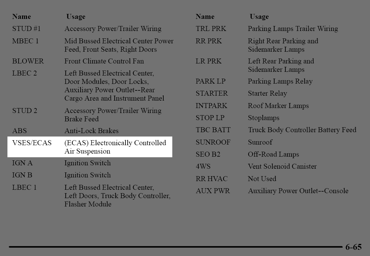

Posts: 2,501
It's shown in the owner's manual as being in the power distribution box undrt the hood, drivers side, near the firewall. Just cut the fused leg and install a switch to the 2 ends.
IMPORTANT: Test this first by removing the fuse. Make sure this doesn't set off warning/error codes. That would create more problems than it solves.

text
