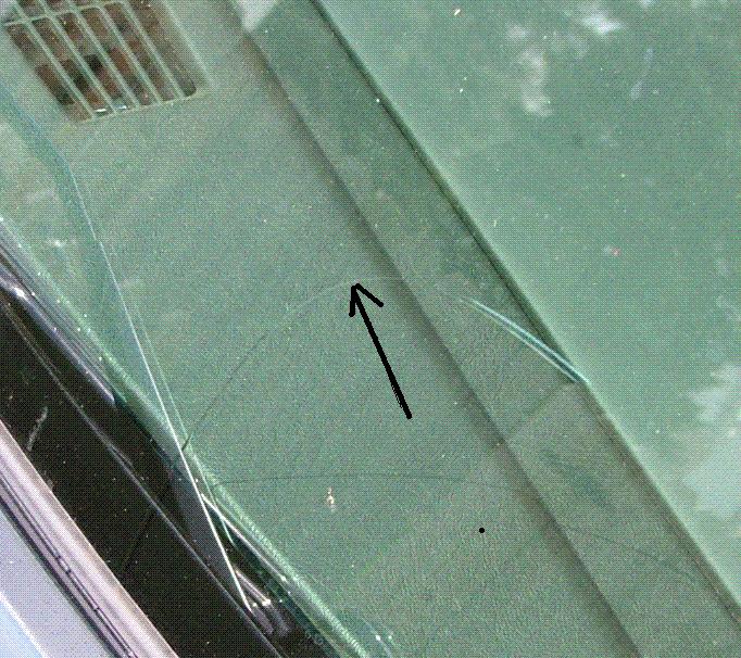

After Waxing my H2 this morning, I noticed a crack in the windshield. It started below the molding and continued upwards. Anyone else had this problem? Mo signs of impact

I had to go get my glasses, No sign of impact on the molding>

Last summer, i was washing the rig. As soon as i rinsed water on the windshield, it cracked right in front of me. From the lower molding to the top within seconds I thought for sure it was a defective windshield because i couldn't find any stone chip. So i brought it to the dealer trying to get it fix under warranty. And the GM rep just happens to be there that day. First he look and couldn't find any visible damage then he used a ball point pen and traced the chip at the very bottom of the windshield, right on top of the lower molding Then told me sorry pal, can't cover it under warranty...

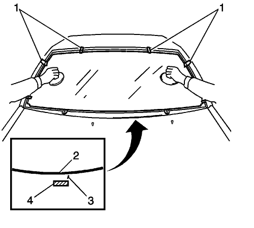

There is a TSB on windshields that sounds like the exact scenario you all are describing. I'd take them to task if it were me. XONXOFF...your windshield crack is right where this TSB refers to. You need to refer to this when you go to the dealer.
Body - Windshield Replacement Precautions
Bulletin No.: 03-08-48-004
Date: August 01, 2003
INFORMATION
Subject:
Guidelines to Prevent Cracks in Replacement Windshields
Models:
2003 HUMMER H2
This bulletin is being issued to advise dealers regarding correct replacement of the windshield.
After removing the windshield, there will be two plastic blocks visible along the lower edge of the windshield opening, each located near the windshield wiper arm transmission spline. These blocks are assembly aids used only when installing the windshield at the plant. They must stay in place so as not to open a hole where they mount. However, upon installation of a replacement windshield, care must be taken to assure that the glass does not come in contact with the blocks.
After applying the urethane and positioning the windshield, leaving an air gap (3) of 1 mm (0.040 in) between the block (4) and the windshield (2), compress the urethane only as much as necessary. This will assure that the glass does not come into contact with the blocks. <span class="ev_code_RED">If contact is made with the block, body flexing may cause the replacement windshield to crack. Cracks along the bottom of the glass are an indication that the glass is contacting the blocks.</span>
Tape (1) the windshield in place. Do not remove the tape until the adhesive cures.
Important: When subletting a windshield replacement, provide a copy of this bulletin to the persons involved in the replacement.

That's interesting to see Jonahs. When mine was replaced the installer was VERY cautious and called his Super several times during the install. He was concerned about those blocks. It also took him many times longer to get it right.
Old 04-13-2005, 02:32 AM
LasVegas LasVegas is offline
Join Date: Aug 2003
Location: \"Lost Wages\"
Posts: 1,150
LasVegas is off the scale
That's interesting to see Jonahs. When mine was replaced the installer was VERY cautious and called his Super several times during the install. He was concerned about those blocks. It also took him many times longer to get it right. </div></BLOCKQUOTE>Yeah. Although this TSB refers to "replacing" the windshield who's to say it wasn't installed incorrectly at the factory. That's my best guess anyway.
