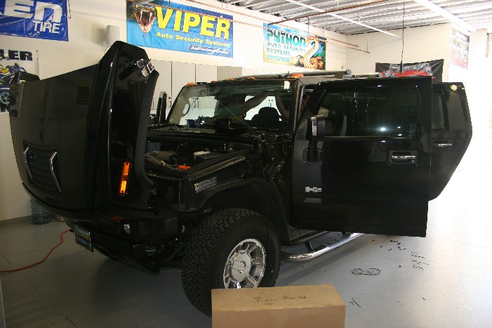

truck

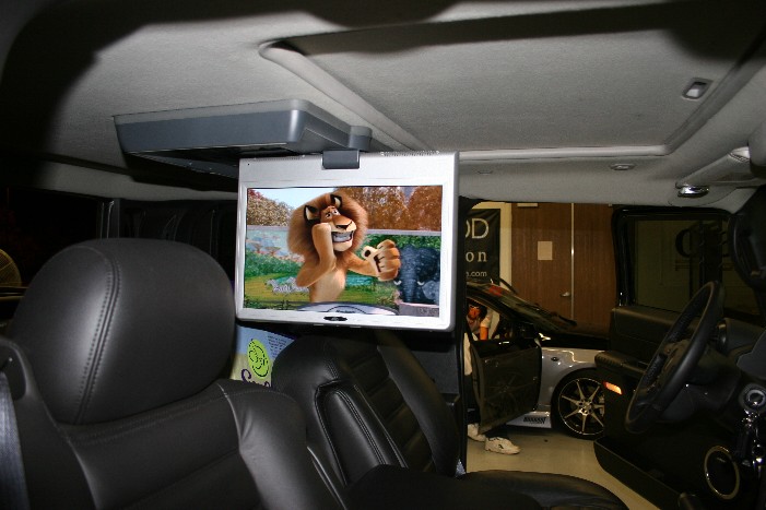

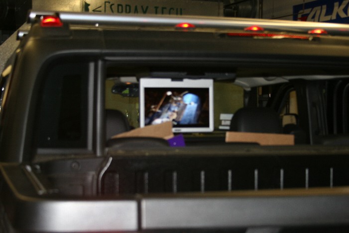

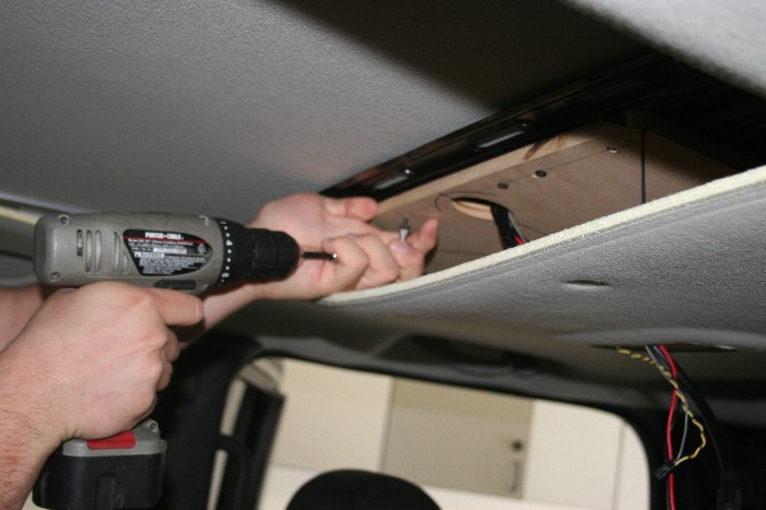

Install of TV
Old 02-22-2006, 08:11 PM
H2_SUT_SC H2_SUT_SC is offline
Join Date: Mar 2004
Posts: 330
H2_SUT_SC is off the scale
We had to mount a piece of mdf to the frame rail that runs across the roof as the TV was too heavy just to mount directly to it. We secured the back of the mdf by using plastic holders that were drilled on and then 3M double sided taped to the roof. It was a tricky install with the sunroof.

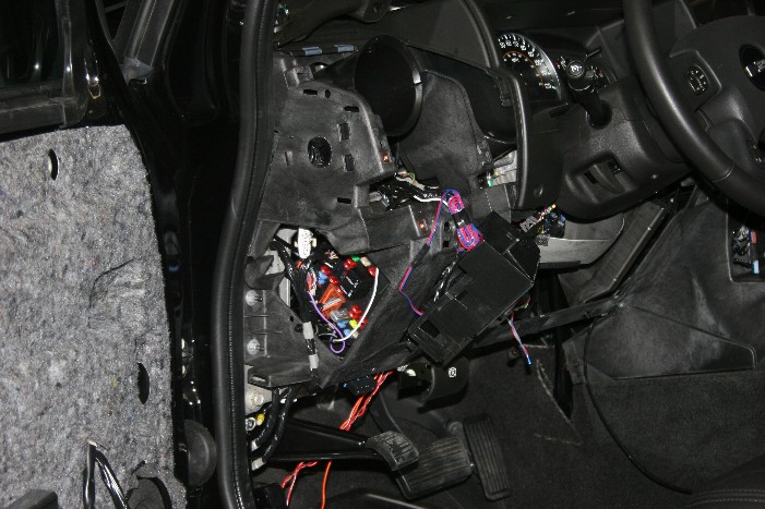

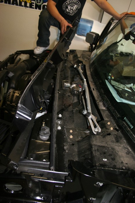

Pic of us tearing apart the front clip below the windshield trying to find a place to mount the GPS antenna.

Truck all torn apart.

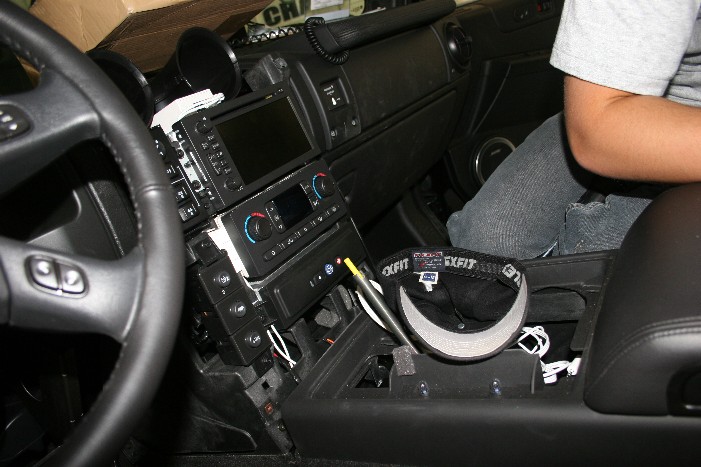

iPod intergration

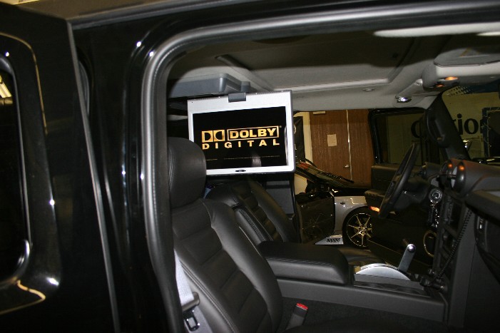

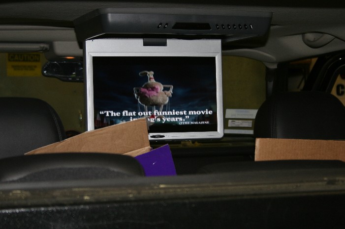

Finshed install of TV
Here's the look from outside the truck.

Another

From the side

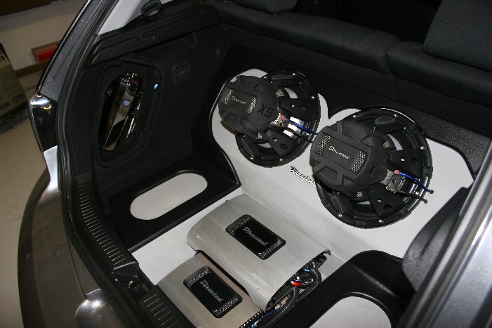

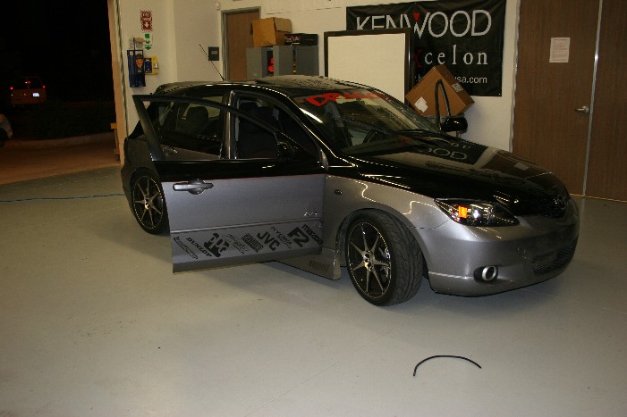

Another install in this Mazda.
Old 02-22-2006, 08:21 PM
Join Date: Mar 2004
Posts: 330
subs in Mazda
