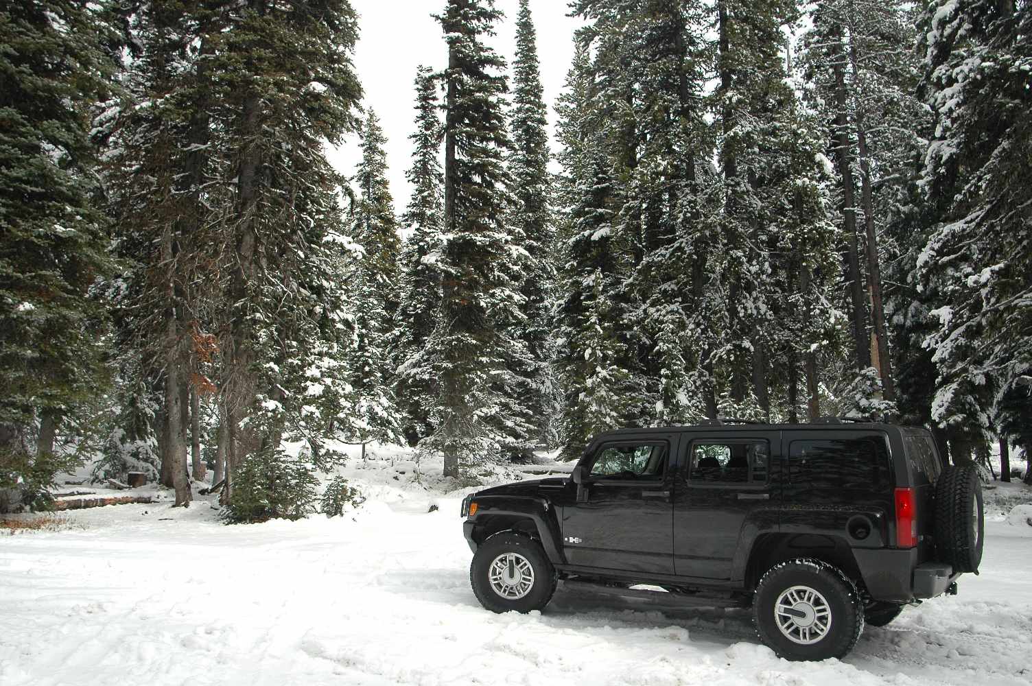

I took the H3 up to the mountains and into some snow. Not really deep snow but the road is gravel/dirt with about half foot of snow on top. The H3 did great on the snow just a couple of anxious slips. I put the H3 in 4 hi and 4 hi locker and didn't see a difference in traction. What do you folks recommend? Sometimes I got it up to 35 MPH if that matters.
