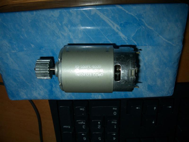

Need help finding this motor:
Little Tykes H2 Adventure series

It is out of this Hummer.
I must get it fixed soon the owner is very upset with me.

Have you thought about fixing the one you have? There must be a motor shop in the area. Do you know whats wrong ie: brush, armmature, bushing???

Probably bushings, gets hot and stops after about 2 mins. I didn't think a shop would waste time on such a small motor.

Have you tried the local hobby store? They will usually have someone, or know of someone that may be able to fix it. I'm thinking like the places that sell R/C airplanes. If they don't have a fix, they may, or probably will have a motor that'll perform better

This is the closest thing I could find:
http://www.mabuchi-motor.co.jp/cgi-b..._ID=rs_550pcvc
MABUCHI MOTOR AMERICA CORP. North America 1-248-816-3100
That looks like the motor

Ok, I looked around real quick to see who made the Hummer for little tikes but to no avail.
I then decided to look up the motor and kept getting all of this R/C crap. Well, it appears that motor is the same that is used in R/C trucks and cars like the traxxus or whatever. Also the 550 number appears to be related to the power of the motor. It looking at that I a beefier motor to replace that wimpy one that was in there: http://cgi.ebay.com/ws/eBayISAPI.dll?ViewItem&category=44028&item=5958610 899&rd=1&ssPageName=WDVW
A little later I'll try to see if there are any distributors but I bet your local hobby store has the exact replacement you need.

Here's a couple http://cgi.ebay.com/ws/eBayISAPI.dll?ViewItem&category=44028&item=5957619 113&rd=1
Just check the dimensions from Mabuchi and make sure that whatever you purchase matches the dimensions and specs. It seems as if Mabuchi supplies to everywhere outside of the us. Johnson motors makes motors for the same type of applications (cordless drills etc...) They should fit/match perfectly... Have fun!

Aaawwwee comon', it's not crap! My boy loves our electric airplane! Aristo-craft trains uses a 550 motor in some of their large model train applications also....
