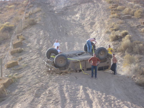

The guy in the red shirt is my buddy Craig, he took his H2 up the same hill twice with no problems. Then along comes an H1 and gives it a shot: he can't lock his rear-end, he has no traction control system beyond the wimpy TT4.
He got sideways and lost it. The H1 flipped over and actually slid way down the hill on its top until it dug-in and came to a halt. I took this photo.
The H2 is an awesome offroad machine...it's a pity that so few owners will ever learn to appreciate its amazing capabilities.
