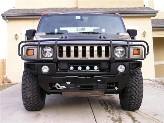

Tim -- Can you post/do you have a close-up pic of the front grille light bar you made? I've tried to get a good look from the pictures on the forum but can't quite figure out how it all works.
I need more lights on the front end and very much like how your setup continues the low profile light look.

I'll get more pics this weekend for you.
You just need to get two set of those P-1000XT's and a switch to match your current ones. You can tie both sets into one switch. run the wires you did on the GOBI rack. Than for mounting the lights you can take a trip to Home Depot and get a falt piece of aluminum to mount the lights to. Once you have them mounted and angled the way you want them, mount that whole bar to the plastic behind your lower grill. Than you have to modify that lower grill to make it work. I posted a writeup on this way back in the day, but give me a call some time this weekend and I can go through some of the stuff with you.

The aluminum is an L, yes? Just need to figure out how to make it all fit with the winch and its power plug...

Nope it's flat. Just send CASH and i'll make you one.

So what's the horizontal, silver thing under the lights?
