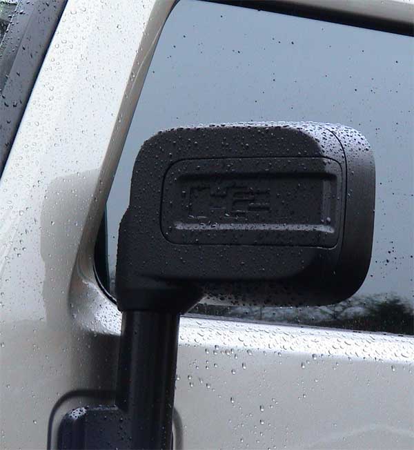

60 mile drive today and it's much better than before the .008 shim mod, now to see how long it will last.

PhilD, This is my second drivers side mirror also :-(
I think GM's thoughts were when they first designed them was "what the hell it's just a mirror" and didn't put a lot of design thought into them.
With the arm being at an angle from the mounting/pivot point and the loose tol. they used, I think the mirror head weight would allow it to bounce around more and loosen things up causing the vibration to get worse.
The new design like DRTYFN has is straight up from the mounting on the door and the mirror head pivots instead of the arm and mirror like ours.
I bet the folding motor is in the head on the new design also instead of in the mounting bracket, just a thought :-)
Also, I found this http://www.automotive.eaton.com/prod...powerfold.html while working on the leaking mirror motor problem I had and the one on the bottom looks real close to the one in ours. Mine had the 203 number on it which tells me I got the old motor design, if Eaton is the mfg of our mirror motors. The only possible help the 204 would be is maybe a more reliable folding motor but would not be any help on the vibration problem.
P.S. I did e-mail them to try and get some info on the motor, Doubt that I will ever hear from them but I can say I tried :-)

Good morning, Kept trying to use the comment section of your site but after a couple minutes the page would refresh and loose everything and after that happening a couple of times I gave up and thought I'd try contacting you this way.
My question and problem.
Question: Will one of the 204 Series Powerfold Actuators fit in a 2003 HUMMER H2 folding mirror ? The actuator in there now looks almost identical to the 204 that is at the http://automotive.eaton.com/product/...powerfold.html site except the one in the truck has a different manufacturer's logo on it, ik ? (not sure what the third letter or symbol is hence the question mark) and is made in Holland.
Problem: When the OEM unit failed to fold the mirror anymore I took it apart to see if I could find the problem (truck is out of warranty) and I found that somehow water got into the motor and circuit board area of the unit causing it to fail, picture included below. (side note, mirror was only on the truck for a year because it was replaced under warranty due to a vibration problem) I was able to clean it all out and sealed up and make it work again and even added a drain hole in case water got into it again. If this problem happens again and one of the 204 series will work in place of the OEM unit I'd like to know I can swap them out to the 204 series.
