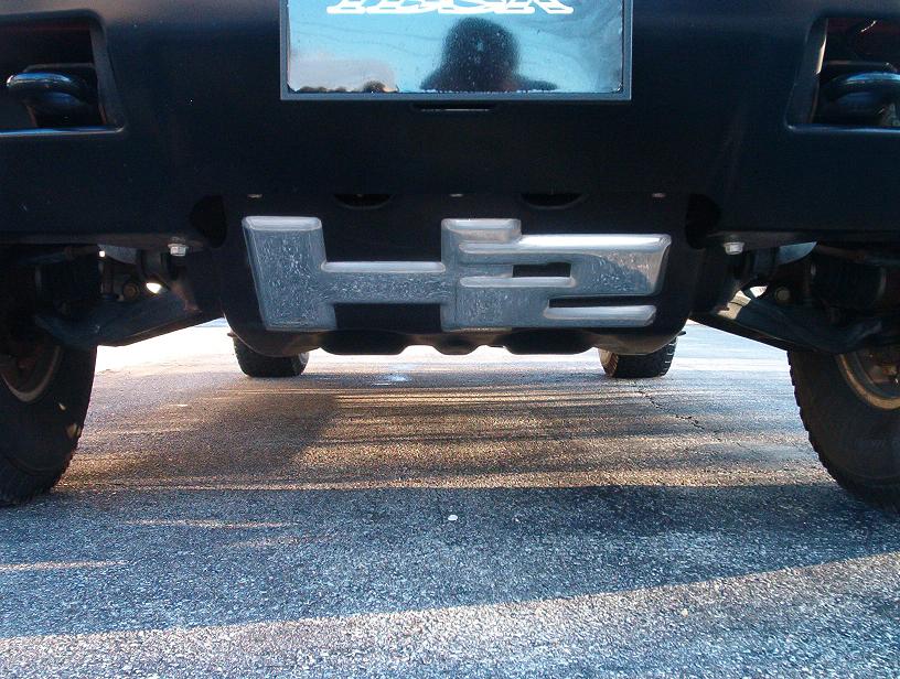

I just finished adding some custom touches to my factory skid plate. I will post some pics tomorrow. I painted the skid plate black and polished the H2 logo. Came out SWEET!! It is a very easy mod for anyone who is into the whole BLING thing.

Did you polish it after the paint? If so, how did you polish it close to the paint, without wearing the paint off?

I did all of the wetsanding prior to paint. After paint and a day to dry good I retaped the edges, did a little buffing and hand polishing with Mothers aluminum polish, and it came out great. I will post some pics tomorrow.

Here's a pic. My camera took a **** before I could get any more off. I will get a few more soon.
Old 03-17-2006, 09:35 PM
Looks pretty sweet. Nice job.

Did you wet sand the whole thing, h2 and all ? what grit???

I wetsanded the H2 logo with 1500 and then 2500 before buffing with a highspeed buffing wheel. The rest of the plate just got a light scuffing with 600 grit.
