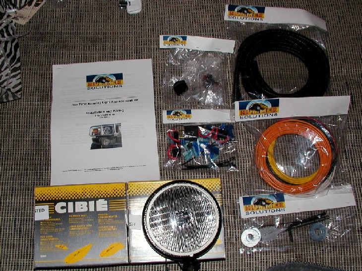

I got started on this and petered out. It's been pretty easy but I just can't do much of anything for very long these days. I'll post the rest of the pics when I finish (who knows when that will be). Here is a pic of the package from hummersolutions.

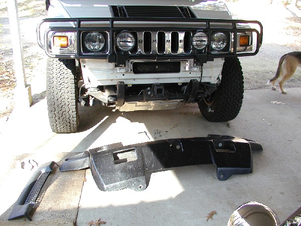

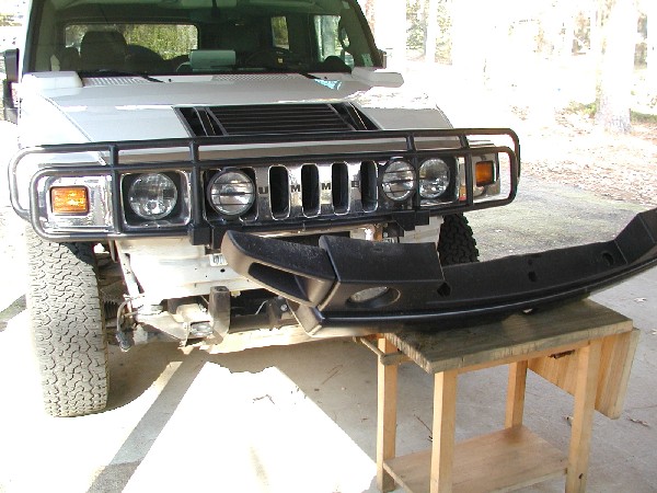

This is the rig with the metal valance and DRL bumper off:
Old 01-27-2004, 07:13 PM

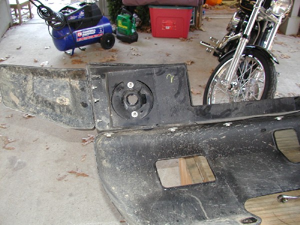

Back of the valance and DRL bumper:
Old 01-27-2004, 07:14 PM
Close up of the back of the DRL housing:

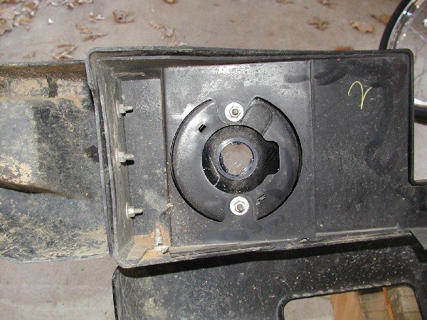

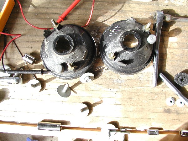

About to separate the DRL's from the bumper and the DRL bumper from the metal valance so I can use a dremel to "adjust" the back of the DRL buckets:
Old 01-29-2004, 02:49 PM
DRL's are out, what the light housing's look like from the back

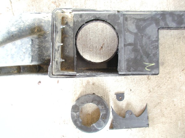

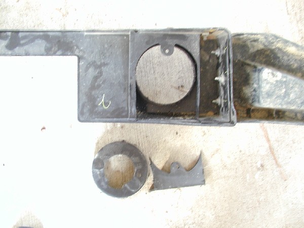

Cut the back of the DRL bumper using dremel and cut the bottom of the plastic insert.
Old 01-29-2004, 02:53 PM
Same thing on the other side, but you also have to cut out the little tab at the top.
Old 01-29-2004, 08:13 PM
Ok, I got a little too excited with the dremel. The previous 2 pictures are incorrect. I made the cuts on the top instead of the bottom of the DRL bumpers.
I had to go back and cut again and now the top and the bottom is cut off. OOPS

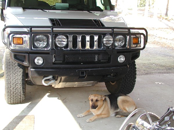

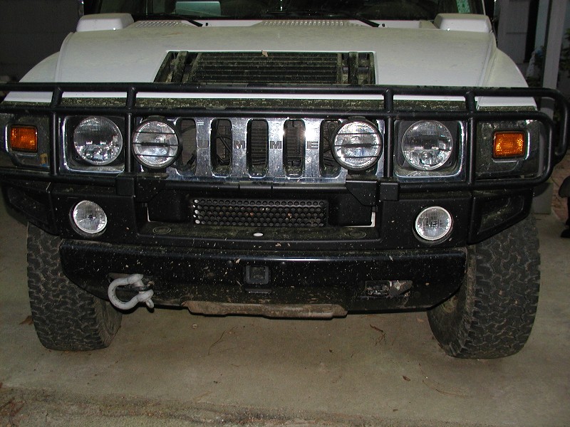

Ok, they're done. I've had them mounted for a few weeks but finished the wiring this past week. I haven't driven with them at night yet but they light all around the front end very well. Here is a pic with lights off.
Old 03-21-2004, 10:21 PM

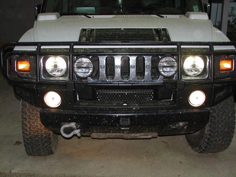

Here is a pic with the lights on
