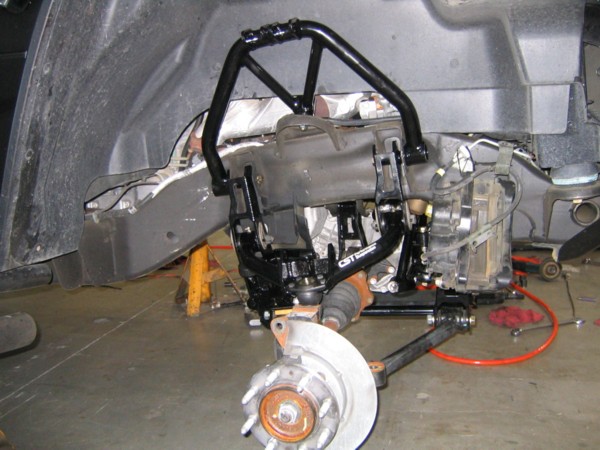

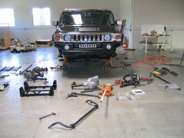

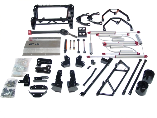

Today I started the install on the H2 It was a long day but I got the front done. I will finish the rear tommarrow and let you all know how it went Here is a pic of the kit.

Old 05-09-2004, 02:25 PM
HGW HGW is offline
Posts: 932
HGW is off the scale
What shocks are you using?
Also, what is CST? Have not heard about them but I like the kit----did you have to do any cutting?

CST California Super Trucks
http://www.californiasupertrucks.com/
Shock are made for this kit for the H2 They are CST Shock
Yes Had to cut off the stock bump stop mounts

Thanks for the info----it is a kit to consider since it has true control arm drops and does not appear to spread the upper and lower control arms. I also like the heim joints. More guys on here should use heim joints since they break tie rods off road.
I went with the FTS 6.5 lift and it really does ride like stock--they do the same thing. I went with King Off Road shocks, more for show than anything else. It gives the lift a real beefy look.
On my next lift, I will go with other, less expensive shocks.

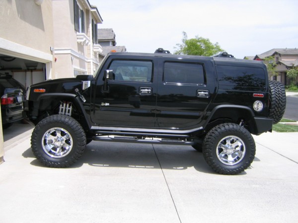

Here ia a pic of the suspention

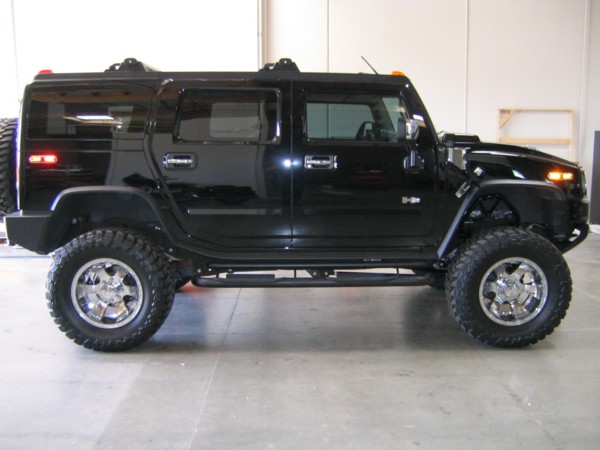

Pic of the finished lift with wheels

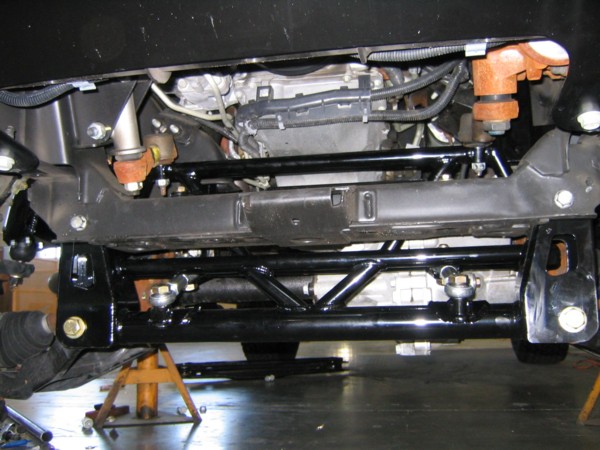

Looks good--when you get a chance, I'd like to see a pic on the steering system up real close---that has been a problem on some lift like this---looks like they did a good engineering job on it.
Also---did you get rear brackets to lower your trailing arms--it looks like it but I can't see it in the pics with the tires on.
I would also like to see the shocks when you get them on.
Thanks

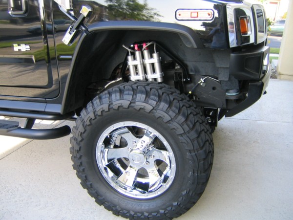

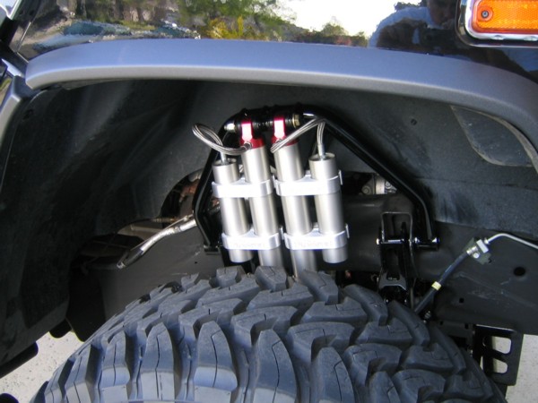

H2 I will get a pic of the steering for you. Trailing arms are in the stock location.
Here is a pic of the shocks.
Tbone So far I really like the kit. Yes it is solid and it rides and handles better than stock I will get more pics later.

pic 2

Thanks for the pics--I thought they would leave the trailing arms in the stock location.
The shocks look good!

Thanks for the complements I like the way the lift came out it sits level not too high no drive line vibration no wheel rubbing on full turns and handles great. My only complaint would be the loss of power with the 38" tires but that can be fixed
