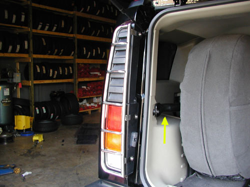

Inside spare photo.

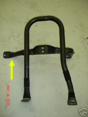

Support

Did you have the tire carrier and you relocated the spare back inside in the cabin?
Is that support piece available to buy somewhere? And how is the installation back inside, is it difficult to do yourself, any drilling or so?
