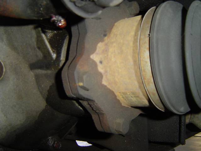

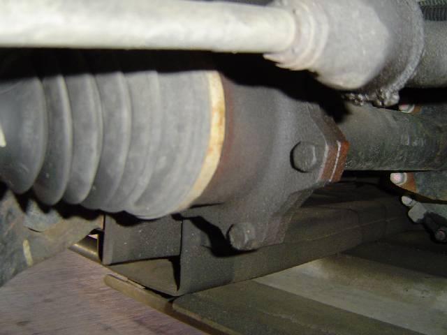

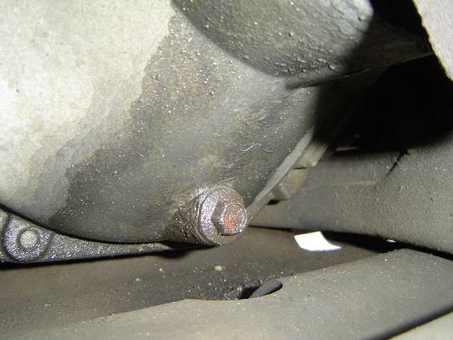

I have not tried the 4x4 settings yet, just got the truck last week. So here you all go.
Drivers side 1
Old 12-26-2005, 07:34 PM
Dave Compson Dave Compson is offline
Location: Las Vegas
Posts: 57
Dave Compson is off the scale
And for drivers side 2
Old 12-26-2005, 07:35 PM
Location: Las Vegas
Posts: 57
Drivers side 3

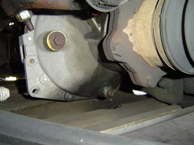

Location: Las Vegas
Posts: 57
And just for reference, heres the passenger side.

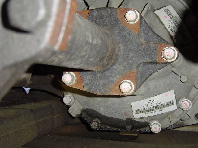

Old 12-26-2005, 07:36 PM
Location: Las Vegas
Posts: 57
Pass side 2

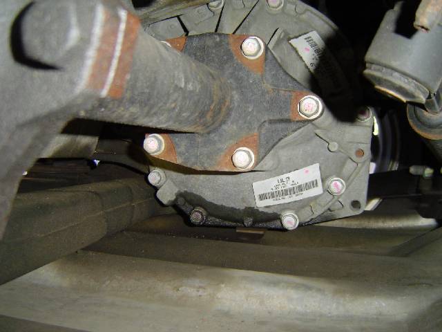

Location: Las Vegas
Posts: 57
And finally number 3, thanks for all the advise in advance.
Old 12-26-2005, 07:52 PM
Location: The Green Mountains
Posts: 2,823
VTSTOMPER is off the scale
could be a seal by the looks to me...
'05 Stealth Gray SUT
A Mellow Mix of Black & Bling
Old 12-26-2005, 08:38 PM
Location: Las Vegas
Posts: 57
A seal is better than a whole new differential. Any idea on cost estimation? And, does it look like its just the drivers side, or both?
Old 12-27-2005, 12:36 PM
Dan Dan is offline
Location: Cognito
Posts: 2,155
Mine looks like that too. Taking it in next week. One of the techs here said he could change both in about an hour which should help you get an idea on cost.
