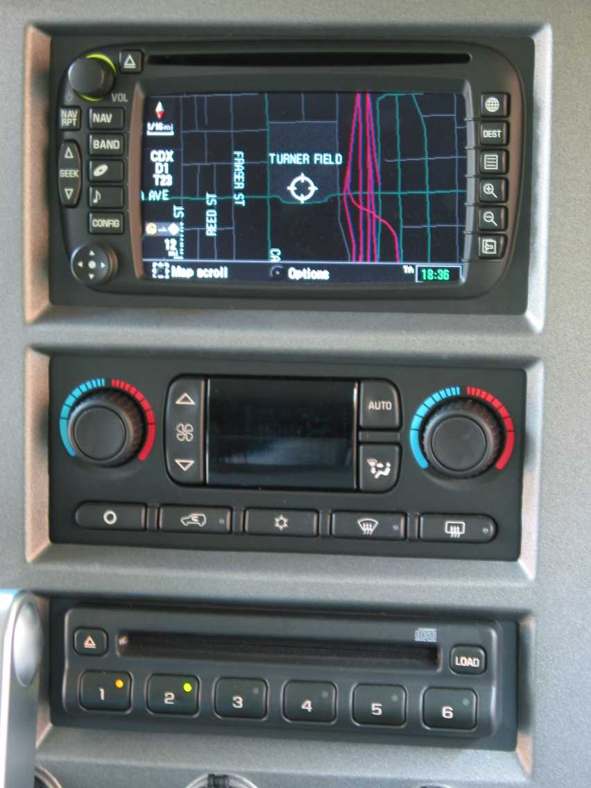

Nope, it won't fit. Also, beware of photoshop edited pictures!

I've got an '04 that came with the cd changer radio. Can it be replaced with the '04 factory nav system??

I'm sure it could be done. However, there was a change in the middle of the 2004 model year production from a Class 2 amp to a non-class 2 amp.
GM now makes both LUX (Bose), and NON-LUX (non-Bose?) navigation head units. As far as I know, all 2003s have the LUX class 2 amp. So you 2004 guys have an additional twist to consider.

GM's XM Radio is really just a separate tuner box mounted under the dash. It uses the same wiring circuits that the 6 Disc CDX changer uses.
I am working on it... Gathering parts now.

what did you do with your onstar since you have the seperate 6 disc changer and was it hard to add the 6 disc changer? What was involved??

Installing the 6 CD Changer involved soldering and adding additional wiring to the factory head unit connectors. Also, a "brace" for the Onstar module had to be cut out from the dash opening. A Dremel and a pair of large pliers took care of it.
