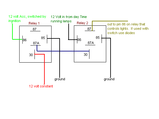

Thanks for the help. I got a relay. The four pins I have a ground, the device, and the reverse light. I only need one more 12 volt wire that is active when the perimeter lighting come on( besides the DRL's)

I just figured it out. If anybody wants their light bar to come on with the preimeter lights and let me know and i will post the relay diagram.

Here is the relay set up to make light bars work with DRL's. Remerber when going from relay number two in pin 86 is a good idea to use a diode. wiring it this way will make sure that the light bar only comes on at night when you push the buttons on the key fob.

Sorry, This does not function like DRL's. It only functions like the Perimeter lighting option

<BLOCKQUOTE class="ip-ubbcode-quote"><div class="ip-ubbcode-quote-title">quote:</div><div class="ip-ubbcode-quote-content">Originally posted by Vt Hummer:
Sorry, This does not function like DRL's. It only functions like the Perimeter lighting option </div></BLOCKQUOTE>That's the point, right?
The circuit is only hot if the DRL's are ON and the ACC is OFF. Correct?

Right. I tried to hook to the DRL's only but when the DRL went on the light bar went on, such as day time. But hooking it up this way only turns it on when the ACC is off and when the DRL's come on. Will only come on when the Perimeter lights come on as described in the owners manual. This works as a switch, you can still hook up to a normall switch too. Just hook into you existing light bar relay on pin 86.
IT works perfect
