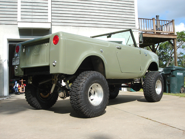

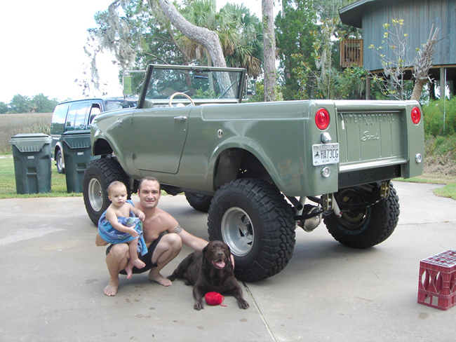

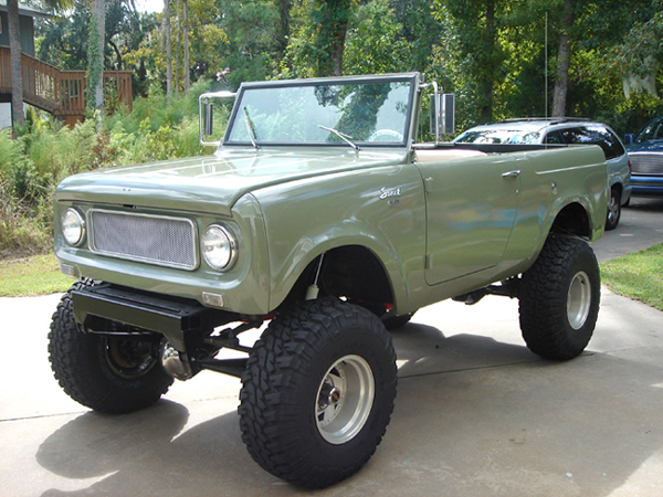

This is the latest project, juts got it done in the nick of time befoe my second child was born 9 weeks ago....time has all but left me for projects having a crazy full time job and an 18mo old boy and a 9 week old.
I still need to get a 6 point cage in her and add the seatbelts so I can cruise the kids..also need to figure out the top situation.
I have a full hard top but it neds to be gone through and painted. I have a 35 year old OEM soft top with the skin in pretty dran good sahpe but the frame needs to be blasted and re-painted and it really needs a new skin made. The local guy I had do my interior said he could make one juts a matter of cash at this point. Here is a pic what do you think?
1969 International Scout 800.
Spring over axel conversion, 4 wheel disc brakes, Hi steer flat top nuckles, stainless brake lines, long travel shocks, f250 shock towers, power steering , power brakes, 266 International V8, Dana 300 twin sticked xfer case, T19 wide 4 speed tranny (manual with granny low), 4:56 gears with lockers front and rear, greasable shakles and a reverse shackle. The underneath is as clean as the top...had every nut and bolt and body panel off of her and did it right... all work done be me down to the paint.
4ht truck I have done and my last for a while, no patience and money for the hobby..I did a 78 Scout II, a 73 early ford bronco, and hghly modified a 89 jeep wrangler..V8 alum heads dual exhaust etc etc....
UNMYFLO
Oh I wanted to take the 800 down to Jacksonville Fla to the HUMMER dealer and run their track with it......It will crawl on its own in 4wd low in first gear unattended...insane to watch...you could pull a house down with it.
It walk all over their track they say portions of it only the H1 can do....hehe

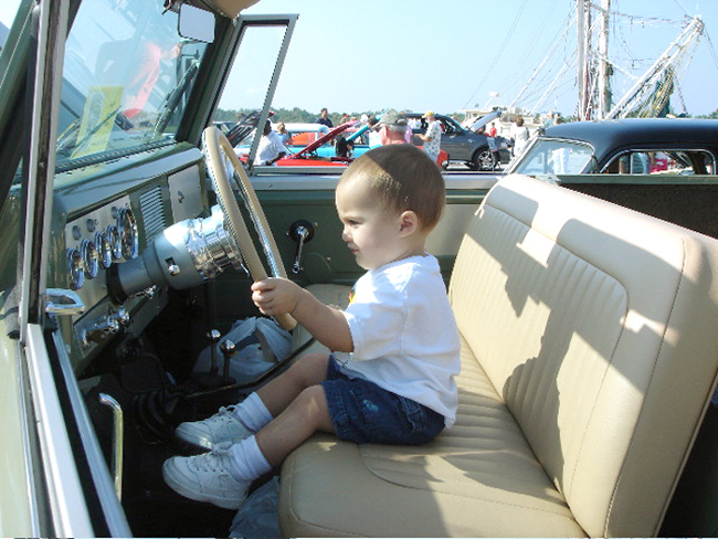

Pic 2 oh and no the first pic wasnt taken yeaterday its a few months old.....: > 0

pic 3

Where is all the dents? The paint makes the body lines look really clean.
Vey nice Job!

Thanks out of all 4 trucks I have restored thsi one gave me the most trouble....several times I wanted to set fire to it in the driveway!
I think I did 80% of it twice including the paint job.....
Thanks again
the paint is Olive color single stage PPG

Almost looks too nice to take off-road.

Thanks F5fstop. I know I do it every truck I am a detail freak then make the too nice o beat the snot out of...I want to do some light trails with her though...water crossing off camber...but no huge rocks and sand paper mud...
Its a classic ya know? Plus I want something left to leave my boy ......

he can work everything he can reach on the dash and loves the gear shift lever!
