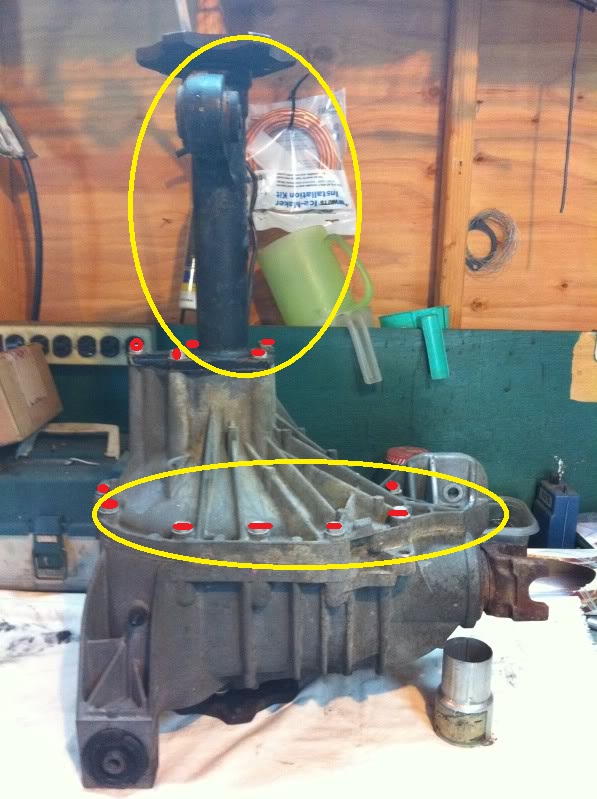

I talk to jarek m a ton, but I am still having diffcult time getting the inner shaft out, i think I might have broken something cause that thing won't come out. I really dont want to bother Jarek anymore so thats why i am coming to you guys. I have been hitting the hell out of it, but not really applying upward pressure since i dont know how would accomplish it.:twak : There has to be somthign holding it in there maybe a clip or something. I have attached a picture of what i am talking about the cicrcle is what I am having problems with. Is the half shaft(black piece) two different pieces which one is suppose to come out or does all of of come out.

Trya prybar with outward pressure on the shaft and hit it straight in towards the diff with a big hammer. If it dont come out you will need to split the case and ry to pop the clip off he end of the shaft.

Hitting it straight back into the diff sometimes will center the retainer and allow it to pop out

How do I split the case? I am new to this but love learning new things when I can. Still kinda confused on the prybar thing where do i put teh pry bar to aplly the upward pressure plus be able to hit the shaft or am I suppose to hit the prybar I swear I am getting stupid by the minute.

Pry between the mount and the axle flange.

ok gotcha! I really think its stuck in there, but I will try again tomorrow. does it need to be unbolted from the diff. before I hit

Nope, it has a retaining ring that seats in a groove on the end. If that ring expands makes it very difficult to get out

Well i tried again today I think I am going to break something, I really need to see a breakdown instruction or something that hitting the shaft with a 8lbs hammer is kinda scaring me cause I really think I am going to break something. I am probably going to get a slide hammer so it even, I have heard you have to buy new rings, man this doesn't make since I would think there would be a inspection hole to where we can gain acesss to the pin in the spider or retaining clip.

At the end of the shaft there is a spring that prevents the shaft from sliding out, you need to apply outward pressure on the shaft to get the spring inside the diff to align and then give it a hit with a 2.5er. Some springs don't come out in one piece there for hawing a new set handy is nice, my came right out, looks like yours are a little more stubborn that's all
This is a different application but the end of the spline looks same #1.

YOU ARE THE MAN JAREK I WAS REALLY TRYING NOT TO BOTHER YOU!!!!! THANKS SO MUCH, its just that these things are so expensive to replace if I break it and I really don't want to go to the stealership and have them do it, cause I could use that money for aftermarket parts you know what I mean. This iste is one of the best around, I have to work until tomorrow afternoon(32hr work day) so i will try again tomorrow after work
